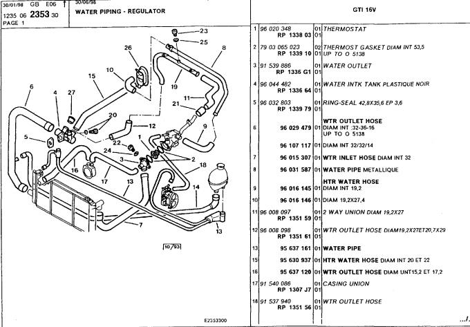

by Jaba » Sat Apr 05, 2014 9:57 pm
This any good ??

by Mike E (uk) » Sun Apr 06, 2014 12:32 pm
Nice one John,thanks.
(We must meet up again soon btw.)
Is number 13 the part required?

by Mike E (uk) » Sun Apr 06, 2014 2:38 pm
the diagram is for a 16valve,
Is your hose not shown?
