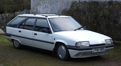

How is the car in general, any pictures?

Pictures as requested.
Have put the alloys back on since this picture taken.
Needs a clean and a polish...

Rare car! Estate version of mine.
