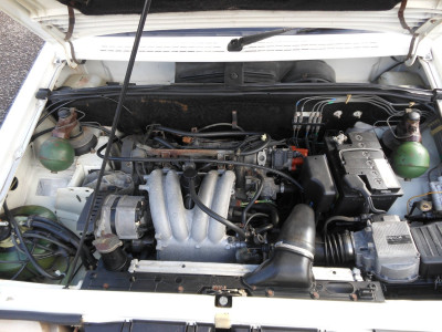

1987 1.9 Petrol Manual GTi - it's listed as an 8V at 130BHP, isn't it more likely to be a 16V?
Hope you can see the pic & that it helps!!
Cheers - Justin

Nope, that's definitely an 8 valve engine; both from the power output and the photo.

Thanks Matt, indeed, someone on Youtube I was talking to agrees, even naming it the DA6 engine with 125bhp
