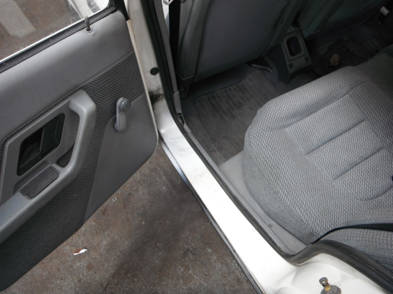

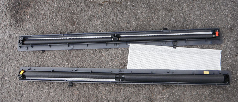

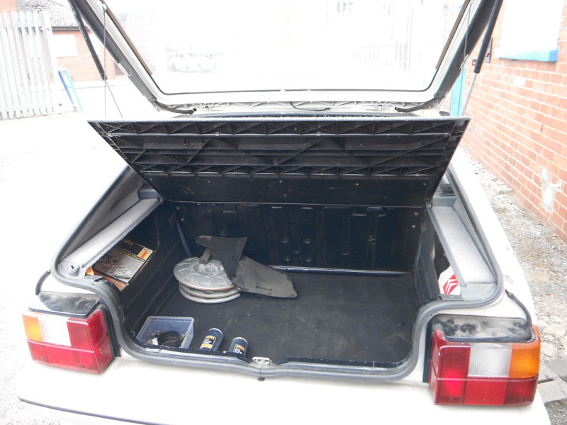

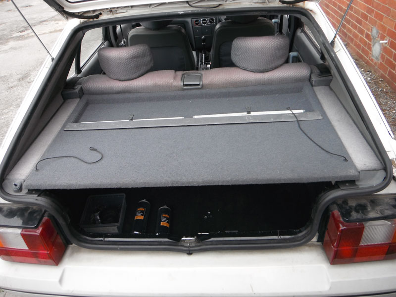

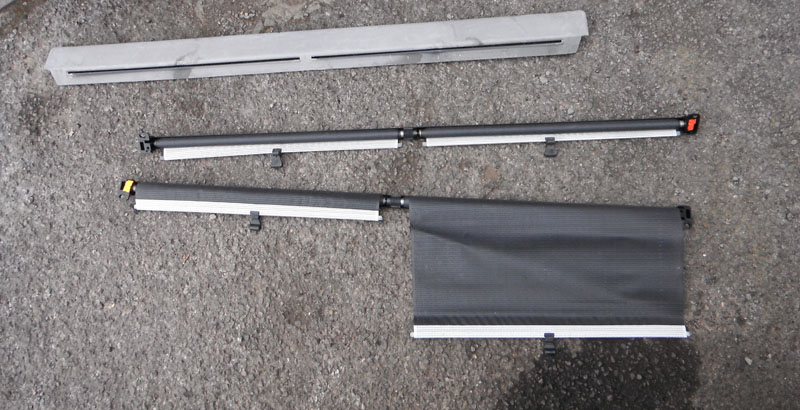

Let's have a little BX update. First thing to report is that even though the BX has been sat outside in lots of rain, the passenger footwell is bone dry. I consider the windscreen reseal a success on that one. Next up was to have a fettle with the parts I'd acquired recently to improve a few things. First, let's do the parcel shelf. My original one has really good blinds and loads of sun fade, the new one has really poor blinds and virtually no sunfade at all. Let's see if we can make one good one out of the two of them. First up, I removed the blinds which is five screws on the back of the parcel shelf, it then slides out of the slots that hold it in place easily enough. You can see here just how faded my original one had become.

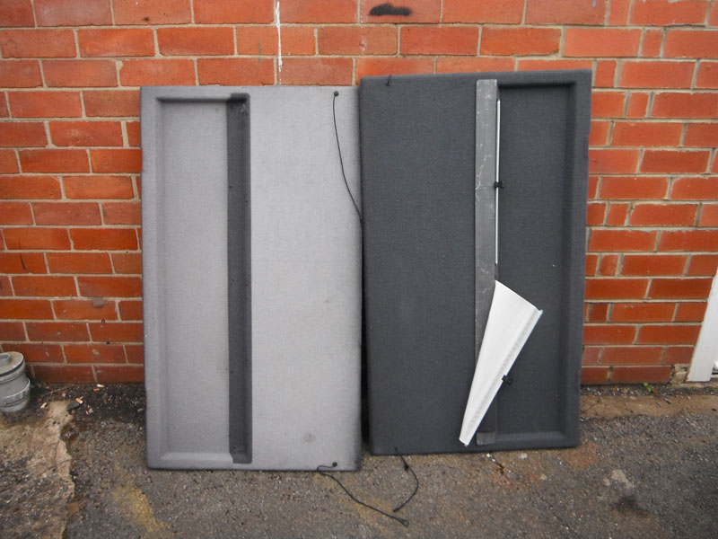

With the plastic piece out that holds the blind you can then inspect what you've got. There's no fixings in here holding the blinds in, they just sit in shaped slots.

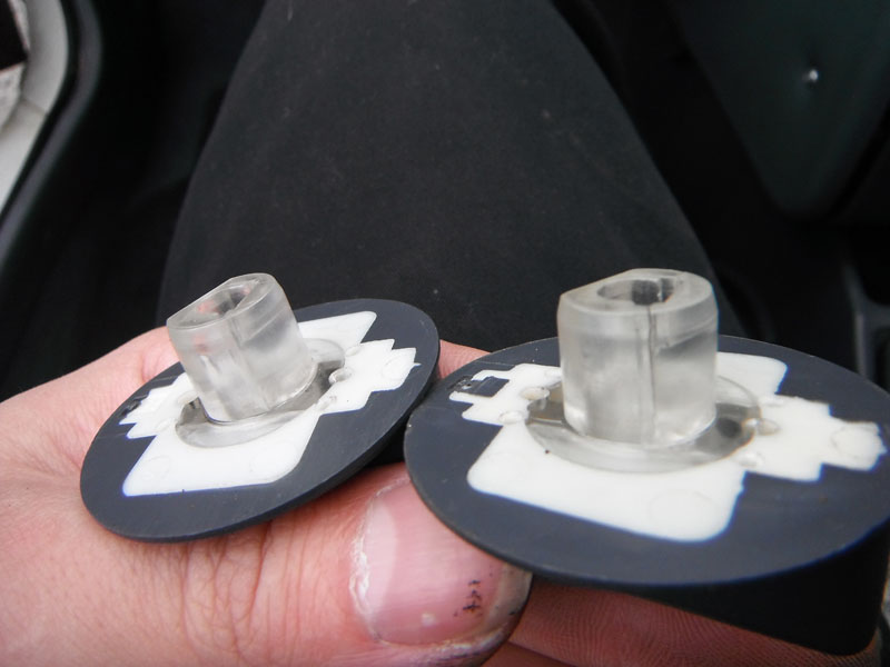

To remove, you simply lift them out. To get the pull tabs out you can flex the plastic slot just enough to get them through without breaking anything. It's then a simple, if slightly fiddly, affair of popping the relevant blinds and holder together before screwing the unit back onto the parcel shelf.

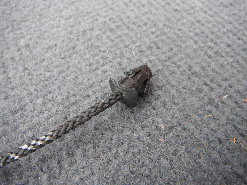

Another thing I noticed on the replacement shelf is that one of the clips for the strings was broken. I simply swapped one from the old parcel shelf. I also salvaged the other good parcel string as a spare for future use, just in case. To remove these, use a small flat blade screwdriver to push the tang in as you apply pressure to the fixing to pop it free. Be sure to keep hold of the little plastic washer this goes through to lock it all together too. Installation was very straight forward. I'm still on the look out for a replacement shelf clip that goes on the back seat to replace the one that shattered. Only problem now is the new parcel shelf highlights just how bad the sun fade is on surrounding parts.

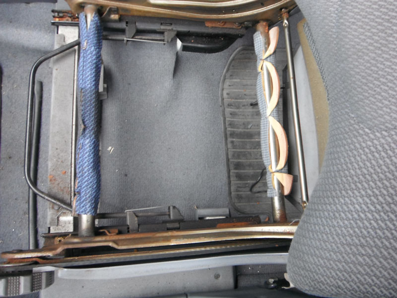

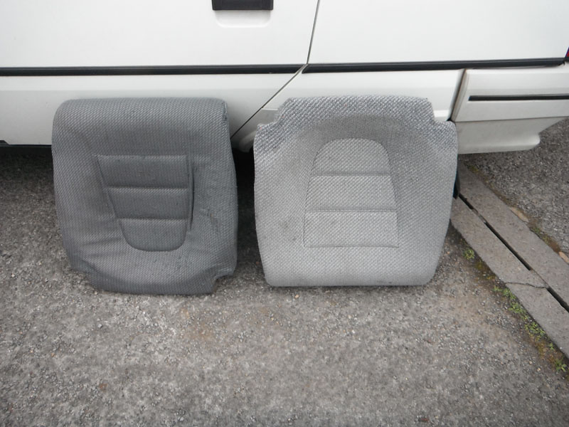

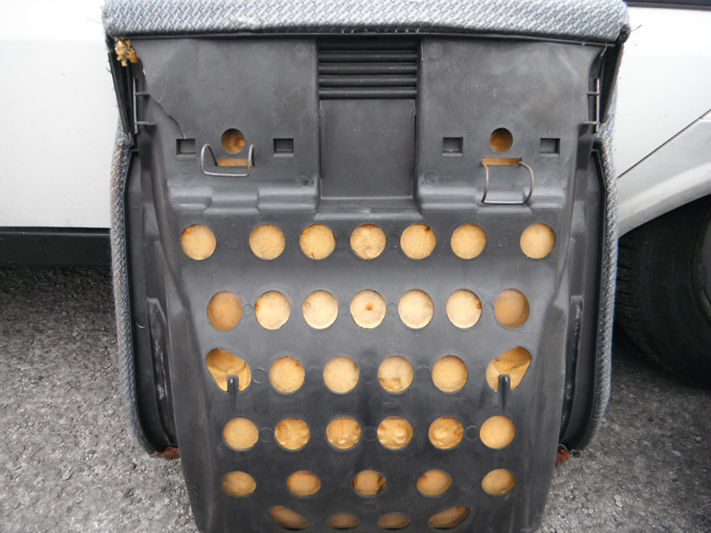

Next job was to replace this passenger seat base with the one I acquired. This is a phenominally easy job. There's two not-tight spring clips at the front just behind the front-back adjustment bar, and two rubber bands at the back that hook into the seat base to keep the seat back trim in place. Undo all of these items and the base simply lifts out.
I got a little scare when I saw the bright blue version of the fabric in the car because I thought that was what the interior used to be like. Honestly, I've never seen a BX with that blue cloth for the interior and that's a shame, it looks fabulous. Mine does seem to just be the usual grey, even though the front grab handles/arm rests are blue and there's a blue tint to the interior fabrics and carpet. I digress.
Side-by-side you can see the wear on the original darker grey base, and how nice the replacement lighter grey base is. Wait... oh bother. Same fabric, different greys.
Oh well, it'll have to do.

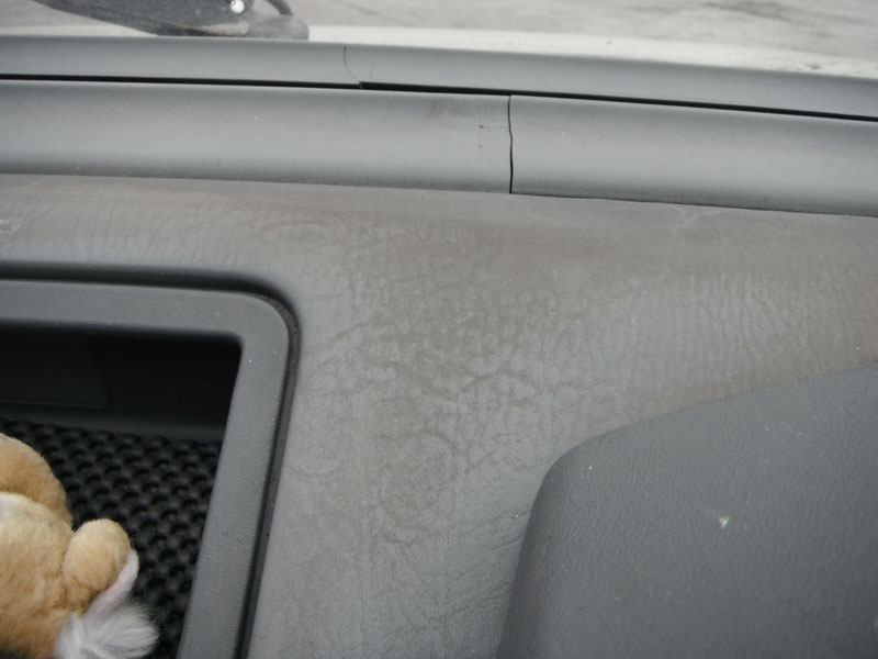

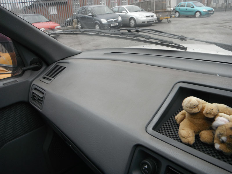

Finally, I had a bit of an experiment with the dashboard. It has a big brown sunburnt looking patch on it, which is plausible given it's life in the sun, and it felt chalky. I know usually once vinyl burns like this you can't rescue it. Nothing ventured nothing gained, I decided to see if I could scrub any kind of 'oxidisation' off, like you would T-Cutting paint, using a variety of potions. The best results came from the Autoglym Insect Remover, weirdly, and a lot of the burn is much less obvious now. I'll keep plugging away at it and give it a protective coat of Autoglym Vinyl to see if it brings it back. The dashboard was easily the worst bit of the interior because you see it all the time and it now looks much better, so I'm happy with that. Surprised too, since it didn't really seem to bring any dirt off on the cloth.
The same process is unlikely to save the door bins which have started to crumble in places where they're nearly white. This also shows how blue the grey fabric is in the BX, I'd assumed this interior was the normal grey tweed and vinyl one but perhaps there was more than one grey offered at this trim level. Perhaps it's just the effects of too much sunshine.

They do fade to a bluey grey over time, the 16v seats which are black do quite considerably.
amazing how a clean looking dash can come up with some scrubbing
You can also get grey trim paint for the door bins.

I intend to get some grey dye to do the worst of the hard plastics, it's probably cheaper and easier than trying to source better matching items. The seats I'm not sure what to do with, I want to keep them in the original grey cloth so really, I need to find another set that aren't so faded if I want to improve matters and that's not going to be easy. Nobody wants the basic cloth interiors so I'm pretty sure they always get binned in favour of the sportier seats.

For cleaning hard plastics, I use CRC Bräkleen that's meant for cleaning brake parts from oil residue, or electronics cleaner PRF 5-56 and 5-55. Some plastics get a white tint after cleaning, but color will come back after plastic treatment (silicone or glycerine inhabitants, I guess) or hot-air gun. Test to a non-visible area first as different solvents react differently, some will attack plastic so hard that it will never be the same (and even crack) so be careful.

I've had better results on hard plastics with brake fluid than I have with brake cleaner, I've found brake cleaner quite good on some vinyls but, as you warn, it can leave a white residue. Brake fluid is a bit messier to work with and you have to keep the part dry afterwards for about 24 hours unlike the brake cleaner, so it's not quite as practical. Boiled linseed oil seems to be the favourite with other folks, I've not got around to trying that one, so perhaps now is the time to give that a go.

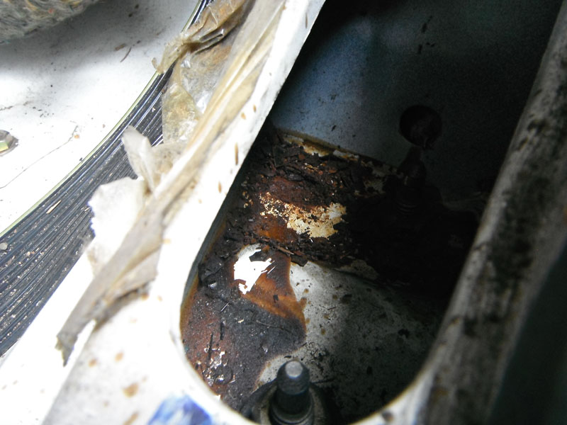

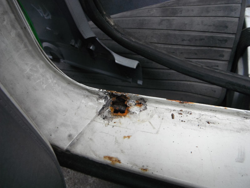

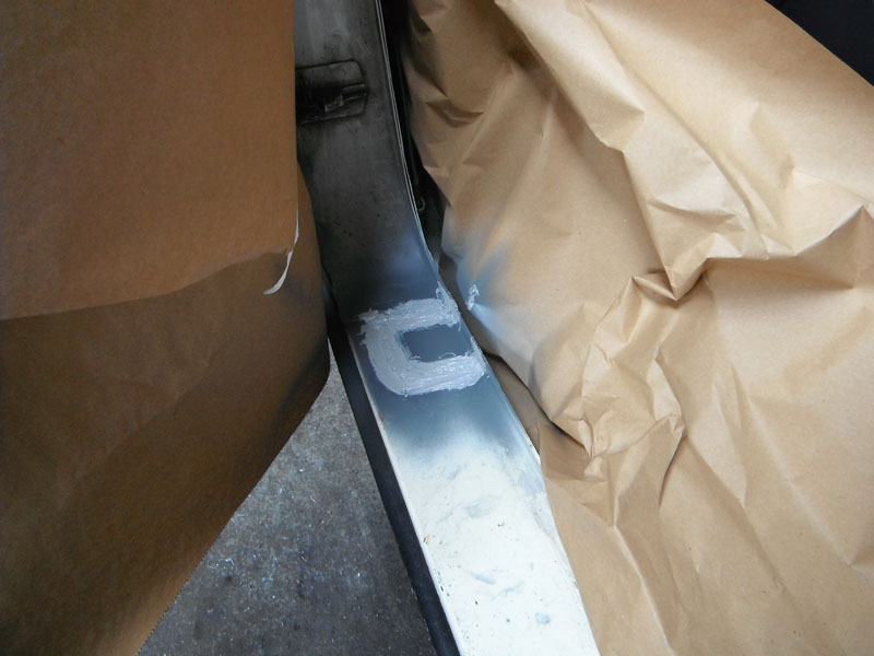

To get to that I had to remove some interior pieces first. Fold the seat base forwards and undo the three 13mm nuts to allow you to lift it out of the car. Then it's a 17mm bolt for each seatbelt, and half a dozen screws for the plastic trims. I removed the trim that goes along the sill completely, but just propped the B pillar trim to one side since I didn't actually need to full remove it. I folded the carpet back out of the way of welding and grinding sparks, and moved the passenger seat as far forwards as it would go, to protect everything from damage as much as I could without dismantling the whole interior. This approach seems to have been successful.

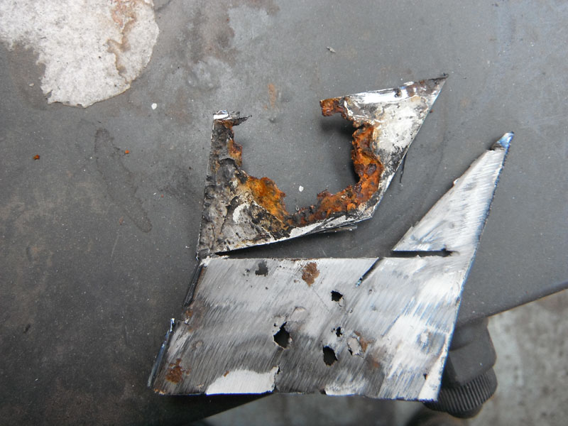

With the trims removed I could see into the pocket that houses the bolt for, I assume, the rear subframe. There's a little bit of rust starting at the seam in there but I'm going to just ignore that right now and come back to it at a point when I can actually drop the whole rear subframe to access it properly. From the outside it's not really apparent there's anything other than some light surface corrosion, at least as far as I could tell, but I'm sure the MoT next week will decide either way.
I chopped out the rotten bit of the sill, and then hit some filler so chopped out how much rust there really was. A nice easy shape to fabricate at least.
Then employed some paper to mask off the surrounding areas. Since there's quite a bit of bodywork tidying I want to do on the sill-down area of the car, it made no sense to make this perfect today so perfect is not what I aimed for.
After weld through primer, regular primer, seam sealer, top coat, and lacquer, it was ready to have the interior reassembled. I want to clean back the sills both sides fully to deal with the minor rust bubbles at the ends where the rear quarter overlaps, a common problem area, and I'll make this repair tidier and neater at that point since I'll likely have to repaint a good chunk of the sills at the same time and it makes more sense to do the area all in one go.
