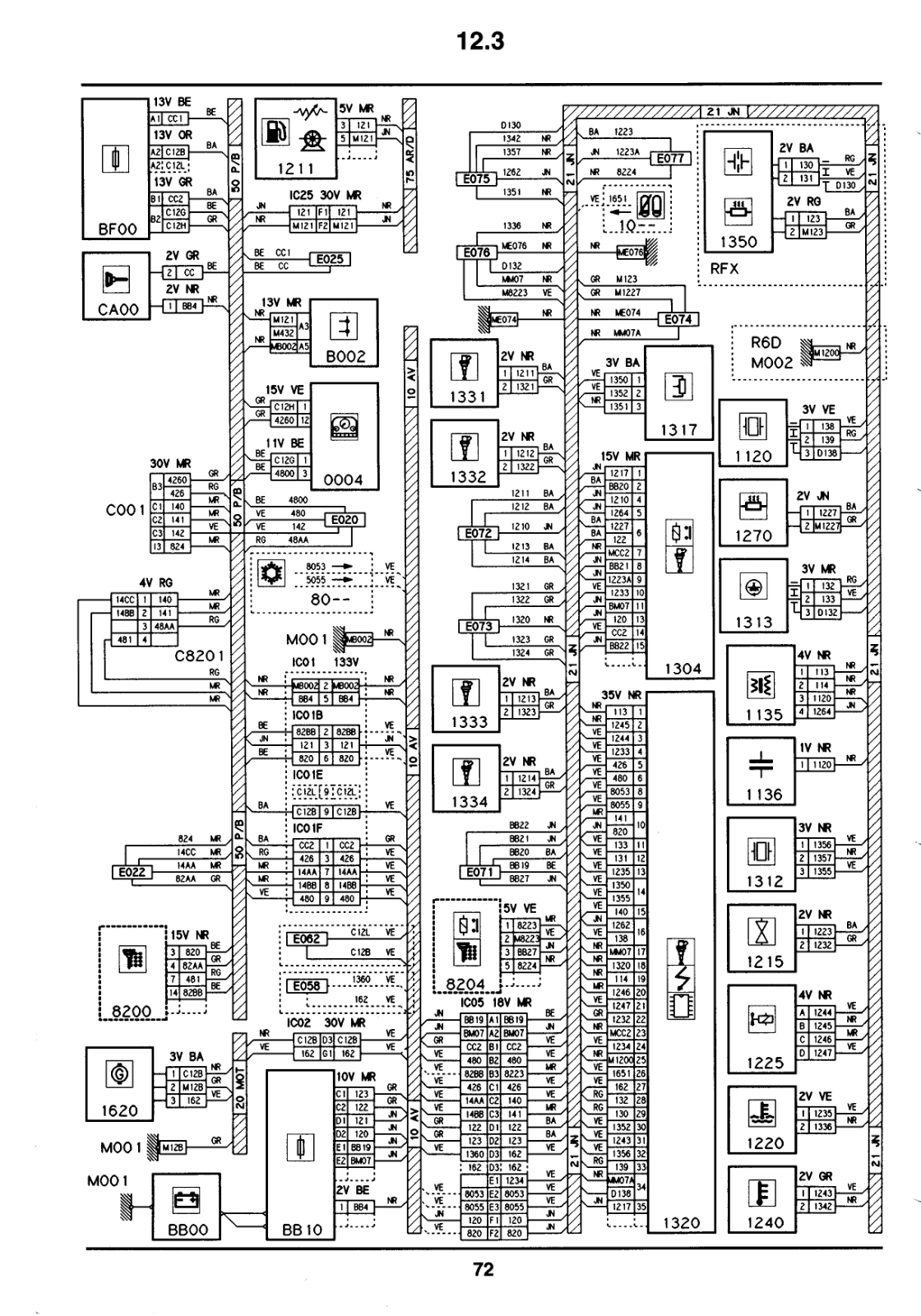

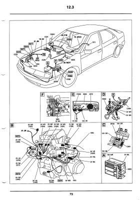

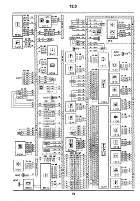

Re: Xantia Dash Lights not showing when ignition turned on - car won't start
OK, yours appears to be a 1995 model-year, so has a slightly different wiring diagram.
I have added the circuit for the hydraulic level/pressure warning, as that should be coming on with the ignition, and it should be somewhat easier to trace than the engine management system. Look particularly at the feeds to and from F12.
Good luck!
Good luck!

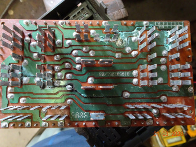

Thanks Mike for the wiring diagrams. The 2nd hand fuse box turned up at the same time so on the off chance I put that in and the other dash lights came up. The car started and seems to be problem solved. Hopefully it was the fuse box and not the fact that I might have disturbed the wiring higher up under the dash. Looking at the photo of the old fuse PCB certainly shows areas of what I guess has been condensation and resulting corrosion on the board, but without knowing which fuse these additional warning dash lights get their supply from and why/how these dash lights prevent starting is a mystery to me. Fingers crossed problem has been fixed. Thanks again for your input.
On the very top of the board in the photo, there are 4 soldered joints and a number of unsoldered pins (soldered on the other side of the PCB. The second soldered joint from the rigth looks suspicious to me, but it could be one on the other side causing the issue, it is almost sure to be one of those pins between the PCBs.Gordon wrote: ↑Tue Mar 10, 2020 5:54 am Thanks Mike for the wiring diagrams. The 2nd hand fuse box turned up at the same time so on the off chance I put that in and the other dash lights came up. The car started and seems to be problem solved. Hopefully it was the fuse box and not the fact that I might have disturbed the wiring higher up under the dash. Looking at the photo of the old fuse PCB certainly shows areas of what I guess has been condensation and resulting corrosion on the board, but without knowing which fuse these additional warning dash lights get their supply from and why/how these dash lights prevent starting is a mystery to me. Fingers crossed problem has been fixed. Thanks again for your input.
Gordon
Good that the problem is fixed anyway.
