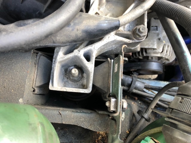

The front rubber of the top engine mount on my 16v is a good way away from the actual mount, so it's high time to get the two reacquainted.

I’ve got no idea what make the existing mounts are! Just that there’s at least a 5mm gap where there shouldn’t be

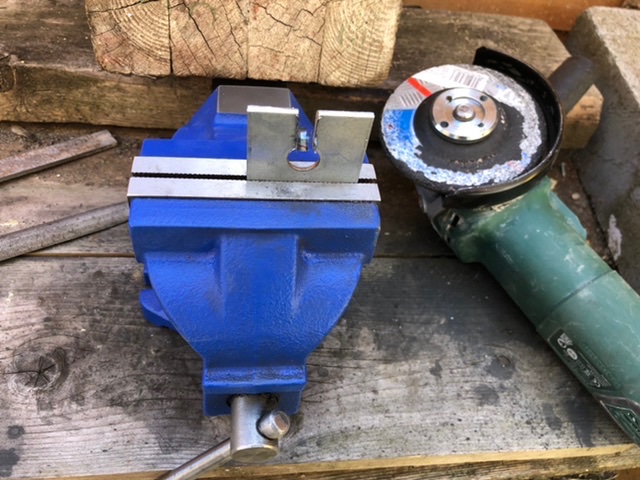

Found some chunky square washers in the shed.
1 min with an angle grinder later and job’s a good un!
