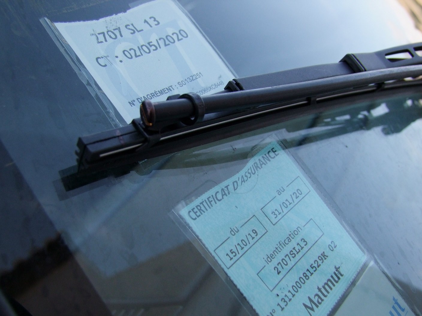

Too windy today to crawl under to fit new rack gaiters, so decided to mod the spraybar instead, as it was a job that could largely be done in the workshop.
Even though the original loop spraybar had all its holes clear, and the pump was delivering ok, the net result was that the upper portion of the wiper blade/screen wasn't getting wetted properly.
So, decided to follow an idea here, and make up a spray-tube that ran the complete length of the wiper blade.
Made in 4.5mm OD black polythene (irrigation) pipe, and a couple of tee-pieces.

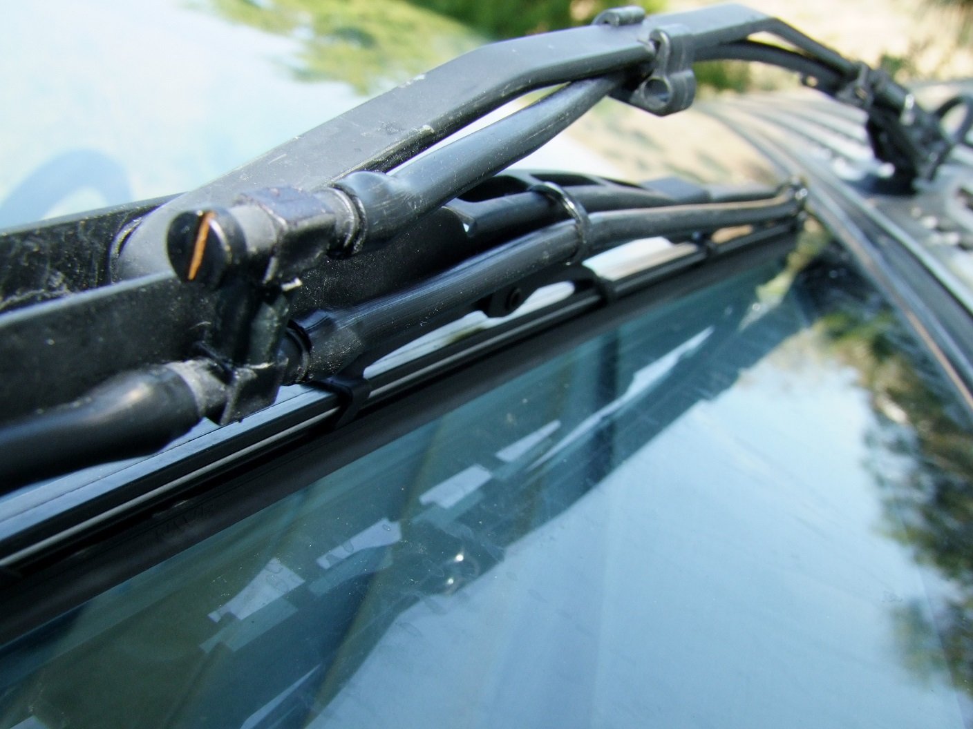

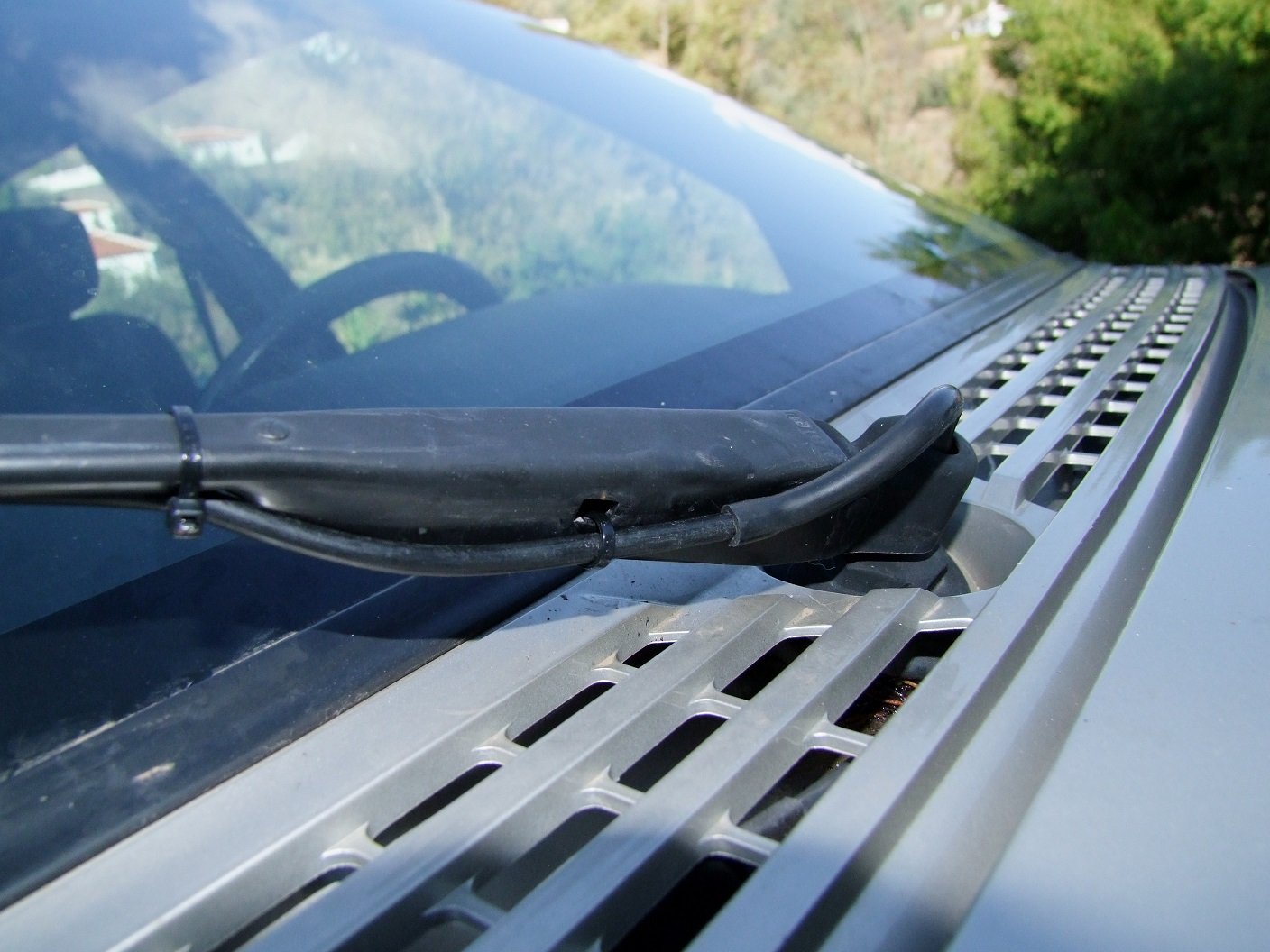

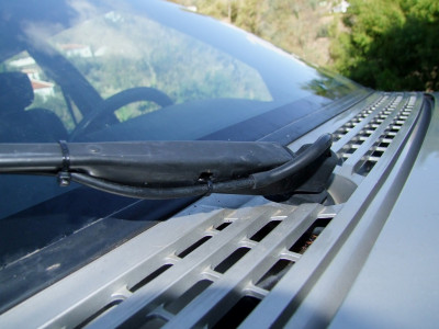

Feed taken from the original wiper-shaft rubber pipe, and along the wiper arm:

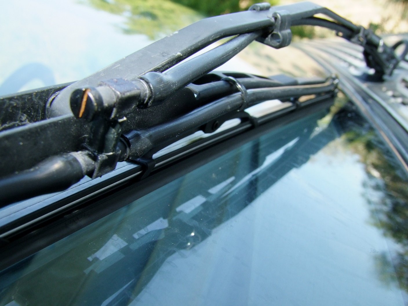

Used the two original clips to carry the 4.5mm tube to a couple of tee-pieces (no elbow handy) at the centre of the blade:

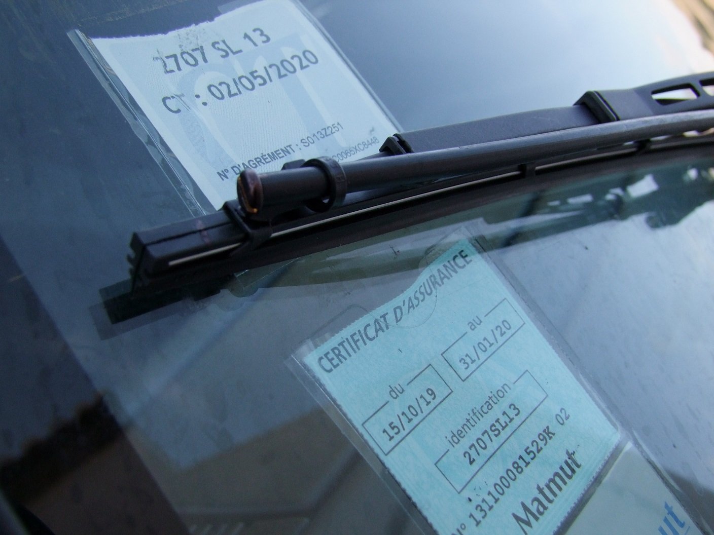

New 4.5mm spray tube goes full length of the blade, and is stopped off at each end with a small screw. Attached with a few very small cable ties. Six holes (0.9mm) along the length of the tube:

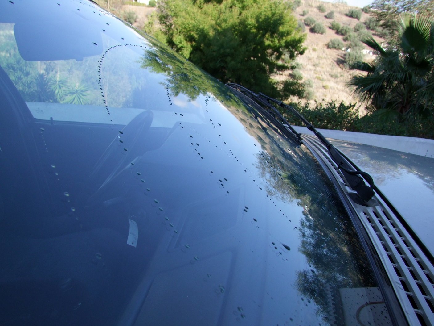

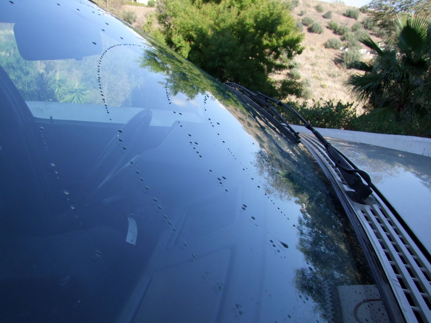

Wash is delivered as six tracks direct to the screen. It'll do for the moment!

Working well, but flow from the wiper shaft rubber tube only producing a 10cm fountain.
As described, found the steel tube/nipple clogged with lots of soft rust. Cleaned out with a 2mm drill and a straight length of wire.
Nipple now delivering a 2m squirt, and screen really well wetted by the six jets. \:D/
Brownie points all round.
