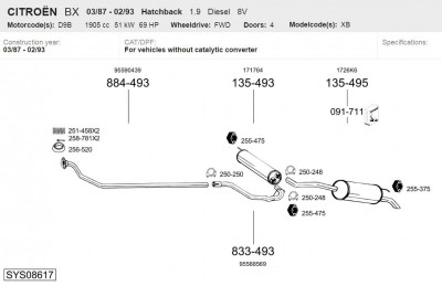

Almost certainly an aftermarket system, but not leaking, and looks very sound. Consists just of one long front pipe, and the two rear boxes. Just wondering whether it's pretty-much "straight-though", and a bit lacking in the baffle department.

I have never found the Bosal systems, on a GTi at any rate, any quieter. Walker was the only one that sounded quieter.
If you check out the TD exhaust you will see that it is different and has different ball and socket connections rather than a clamped pipe on a spigot.The major difference is the middle box as this is larger and might absorb more sound. The tailboxes are straight through and have glassfibre packing for sound absorption.I think the petrol 1600 and 1900 systems are the same as yours.
No easy way to convert one to the other unless the long front downpipe is the same diameter.
Exhaust noise in practice is not a noise nuisance at speed as the road and wind noise drown out even the engine noise. On my petrol GTi there is an annoying exhaust resonance of increased noise from 55 to 65 but you just learn to live with it as it would take extraordinary sound deadening measures to the car interior to mask this.
