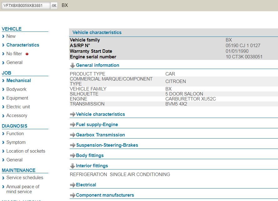

white exec
- Posts: 681
- Location: Sayalonga, Malaga
- LHD, NA, AC, RP_5800
Re: BX 1.6 TGS Athena rad.
The range of radiators fitted to BX was/is lengthy.
Cit parts lump all these together (even for your VIN there is more than one listed), but my best find was
95 495 038 22dm² LAR600
for 1580cc with A/C (which yours is listed as having; it is also listed as a Millesime).
On Mister Auto, 95495038 throws up these two as replacements:
Nissens 61660, listed as 600mm
NRF 58683, listed as 600x378x34mm
Both, unfortunately showing Out of Stock on MA UK, although MA.es show 3 NRFs available.
If you need more help, can you post a photo of your existing rad (particularly to show the top of it and filler) and check dimensions of it?
BX 16 didn’t have a/c fitted unless it was a Mk1
white exec
- Posts: 681
I was just going by Parts Characteristics, Tim:
RP 5190 = 24 Jan 1991
