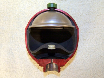

What finishes spheres off (apart from extreme old age) is driving the car with very low gas pressure. This forces the membrane upwards, against the internal pressed-steel dome that holds the diaphragm in place. Some of the aftermarket spheres have less-than-smooth edges on the perforations in this plate, and this can damage the diaphragm. (Genuine Citroen spheres have rolled-back edges to these perforations, and the problem is avoided.)
In normal use, at correct pressures, the diaphragm will never touch this metal dome, and neither will it be asked to flex upwards by that amount. It's usually reckoned that if a sphere's gas pressure has dropped much below 15 bar, it ought to be ditched, rather than re-gassed.

There's a really good and well-illustrated post here (on FCF) all about sphere failures:
https://frenchcarforum.co.uk/forum/view ... 13#p649013
