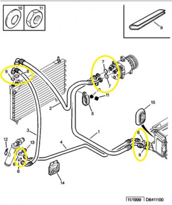

- renew the O-rings (compressor, dryer, bulkhead TXV) . . . fortunately, Citroen still list these all as available

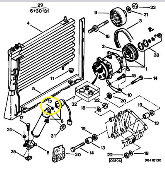

- renew the dryer

There are 14 o-rings to change. Any aircon supplier can fix you up. You will need several sizes 3 or maybe 4 I can't remember. They are coloured green for aircon.

Yes a new drier is required. For charging the standard R134a screw on high pressure red coloured conversion connectors are all you can use on the basic schrader valve on the existing connection. They have been known to leak so buy a spare as well.

Lastly make sure that the drier is the right one cos your old and brittle a/c hoses will not like being twisted into new positions. I have a list of part numbers somewhere if you need them.

The new drier has its connections in exactly the same positions as the existing ones, which helps, and matches the OE pt.no.

Hi Jaba,
You said there were 14 O-rings to change.
I can account for 9 of them...
. Is that right, or just the #14 service pack (now NFP) ?
Thanks.
Thanks.

Yes I did. The extra ones are: 4 needed for the expansion valve input and output this is in addition to the two on the diagram for the hoses and one more not shown for the drain plug. No idea about the service pack I get mine from an a/c equipment supplier in a kit of a lot more than 14 of many different sizes.

Re: A/C - conversion to R134a
Thanks for the really quick reply.
. Any idea of size of those four?
LHD, so that will be fun.
Is replacement essential?
Thanks.
Thanks.
