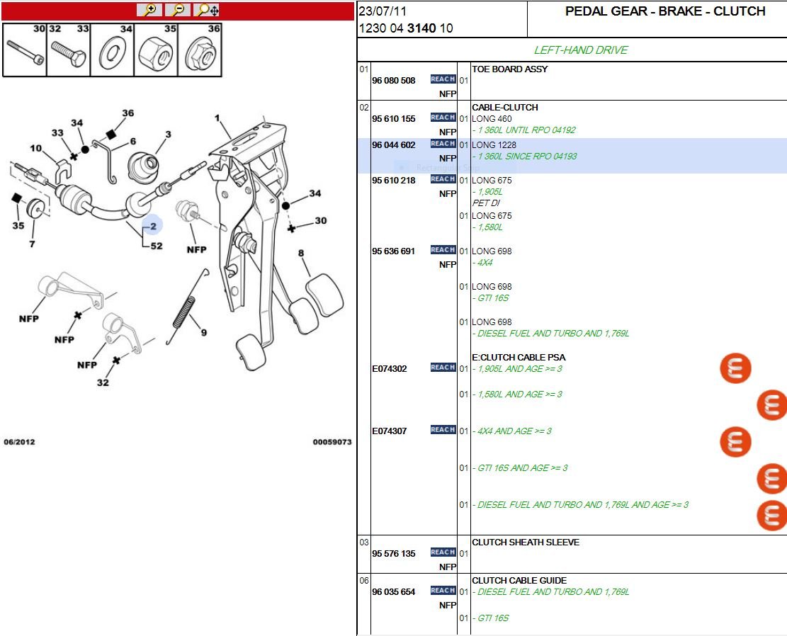

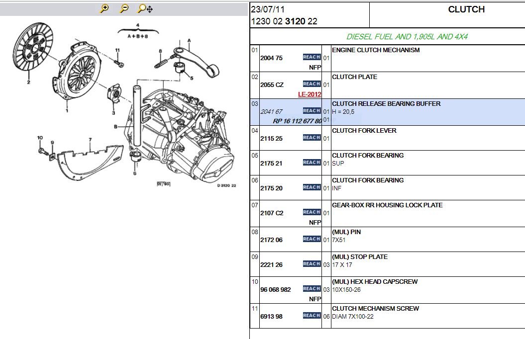

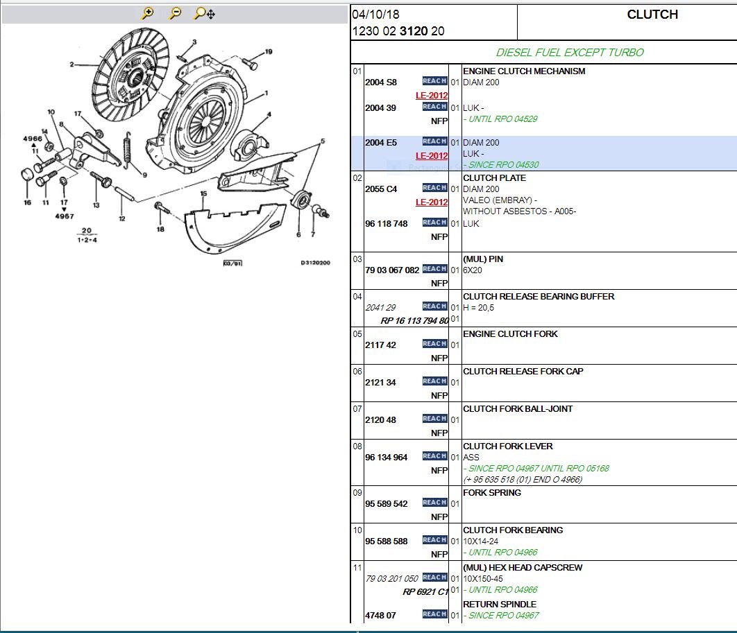

LHD is a lot simpler for clutch cable, which is shorter than the RHD version.
Some parts diagrams, in case useful...
? click to enlarge
spigot-type
spigot-type
shaft-type
shaft-type
pedals, cable
pedals, cable
