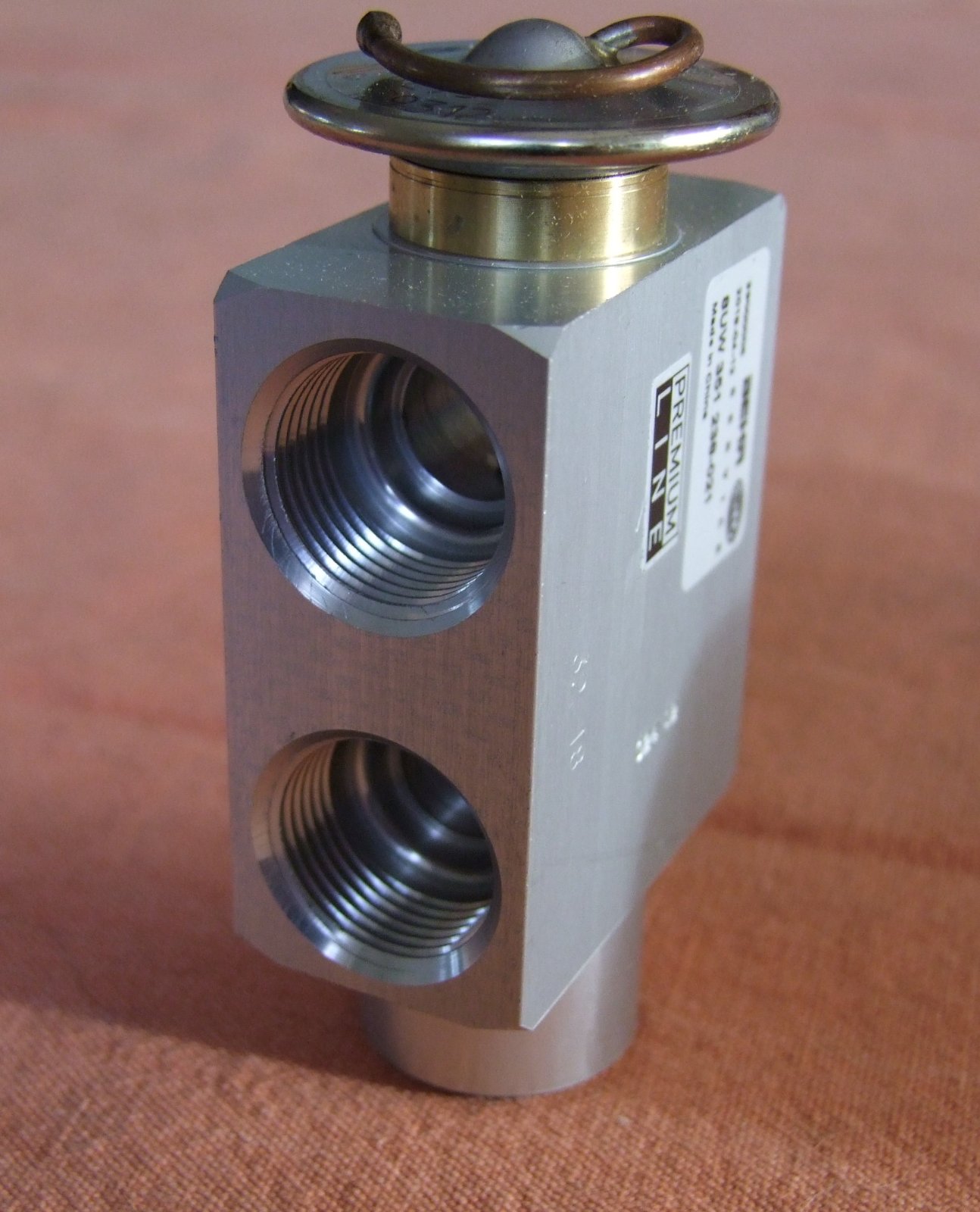

Does anyone know the sizing of the two sizes of O-ring for the TX valve?
Have taken delivery of a
Mahle Behr AVE87000P, which comes without the rings.
It's equiv to O.E. 6461.J3 (NFP, and Parts not showing the O-rings),
and same as Vemo V15-77-0003 and Valeo 508690.
Measuring the device isn't straightforward, as there are a couple of possible positions for the seals.

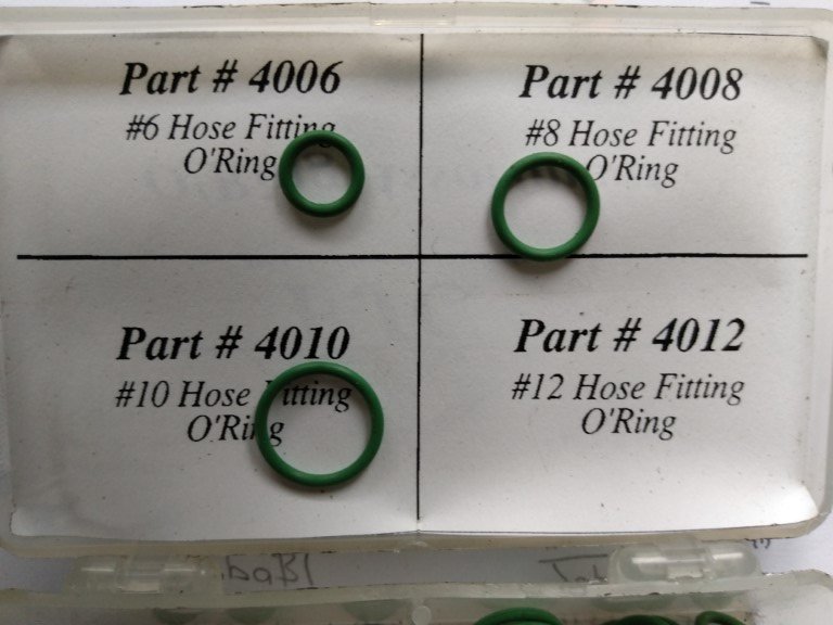

Located my stock and here are some pics. You need 1 x #6 + 1 x #10 for the external connections and 2 x #8 for the evaporator side.white exec wrote: Tue Jun 15, 2021 4:45 pm Aha! The man who can!

Hi Jaba,
Thank you for finding all those - perfect!
After a lot of legwork, I also managed to get an email confirmation from this company https://www.swisclima.ch/en/fans/g/4010/art/16808
that the sizes are:
I.D. x thickness (mm)
7.65 x 1.78
10.82 x 1.78
14.00 x 1.78
with all three in this HNBR kit from Amazon:
https://www.amazon.co.uk/Kissral-Assort ... 386&sr=8-1
