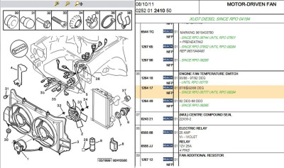

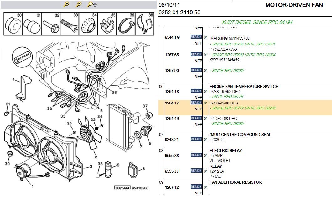

Cooling fans and radiator thermo-switch
This is where the fun begins.
The point at which the radiator electric cooling fan(s) kick in - at low speed then high speed - is set (on BX) by a "thermo-switch" let in to the radiator. This thermo-switch senses the temperature of the coolant leaving the radiator, and about to be sent round the engine block. If it's too hot, the fan(s) are instructed to kick in.
Details of BX thermo-switches on Citroen's parts pages can be a bit difficult to pin down, and several different switches were fitted to both petrol and diesel XU and XUD engines. The most informative pages actually appear for C15 models which got twin fans for their 1.7 engines. Interestingly, a thermo-switch listed here was also used on BX16S.
. For the C15, three evolutions of thermo-switch are listed:
1st figures are cut-in and cut-out temperatures for Slow speed; 2nd figures are those for High speed.
1264.18 93°/88°C — 97/92 (for cars up to RP 5776)
1264.17 87/83 — 92/88 (for cars from RP 5777 to 8284, as well as BX16S)
1264.49 92/88 (for cars from RP 8285 onwards)
In fact, there was even an earlier thermo-switch:
1264.14 88/79 For petrols, except the 16S
Now that would provide some really cool running!

Well, good stuff, but what about the BX19D (twin fan, with AC) here?
When I acquired the car, the thermo-switch was in bad shape: its spade terminals were badly bent, and so I opted to replace it.
I inadvertantly opted for a 1264.18 equivalent (a Valeo 819773), and fitted it.
The RP number discrepancy was small (ours is RP 5800).
Result, though, has been unacceptably hot running. Not in normal driving, or at speed (when there is a good blast of air through the radiator), but when hill climbing, or in slow-moving traffic. Here, the (newly installed) temperature gauge runs up to an indicated 100°C+ (but thankfully not further) before the High speed fan cuts in. I think this is pushing things a bit for an XUD.
Having run like this for a few days, I decided to look again at thermo-switch specs, and have now plumped for, and fitted, the 1264.17 (an FAE 37800), which cuts in fan Slow speed at 87 rather than 93, and High speed at 92 as opposed to 97°C.
Some prolonged hill climbing today has brought the temp gauge into a much more comfortable region, so am pleased with that.

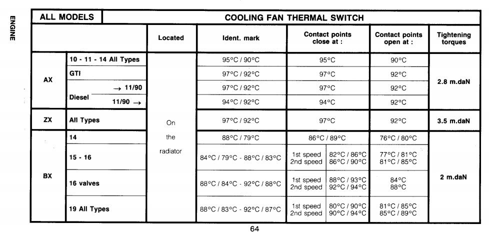

Exec, I have fitted a lower temp thermo switch to my 16v. Full fan speed from 92 to 88 and half speed from 87 to 83. The issue is, by the time the fan kicks in at half speed, the gauge is already up to a 100. And full speed kicks in only intermittently at 110.
The hose where the thermo switch is just doesn't get hot enough, while my head is cooking. I've flushed the system twice, the coolant is clear and free of any debris. I checked the temps with an infrared thermometer and the head and thermostat area is indeed up to ~105 when the gauge is at 110.

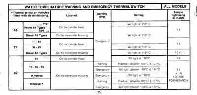

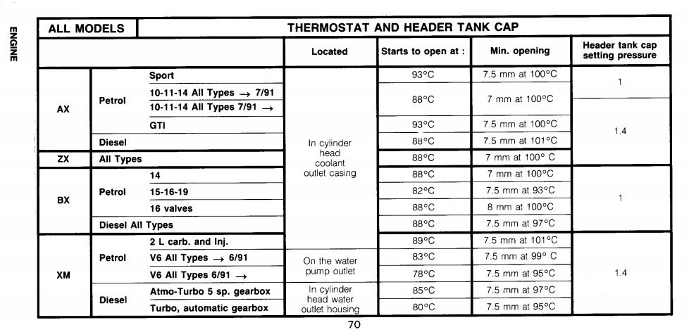

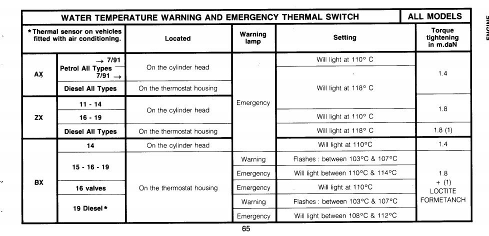

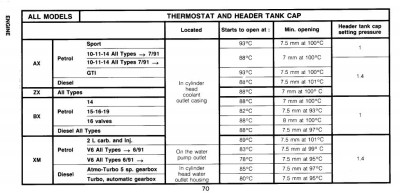

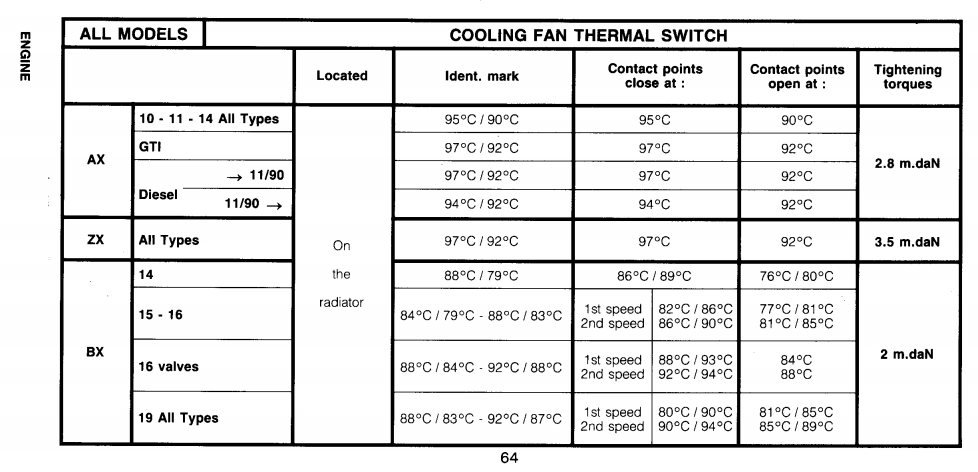

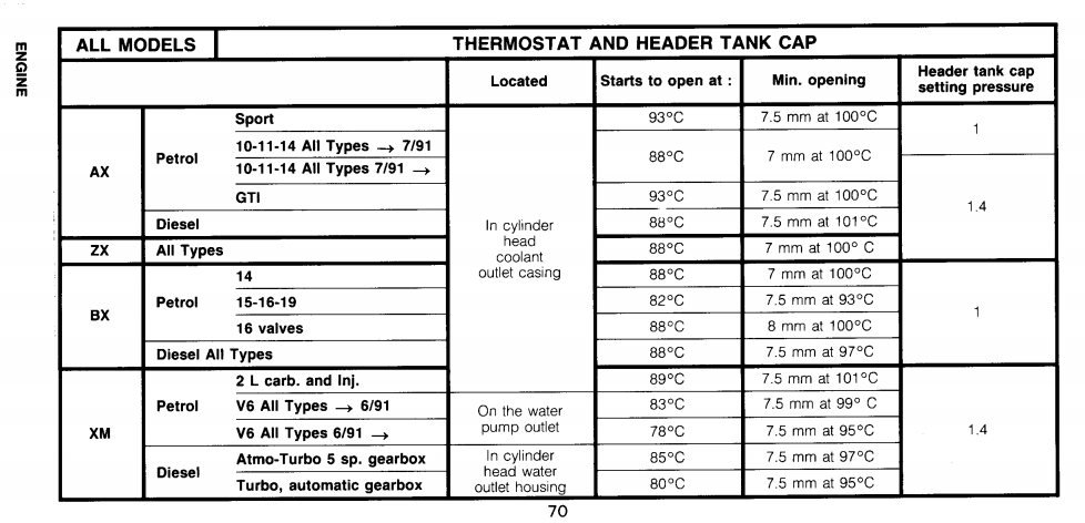

Looks like listings for both 82 and 88 thermostats:
Haynes: 79-82°C
Citroen Parts (ServiceBox): 1338.03 listed for the 16S
Mister Auto (PSA/Stellantis): lists both as 1338.03 equivalents, and as the item for the 16S

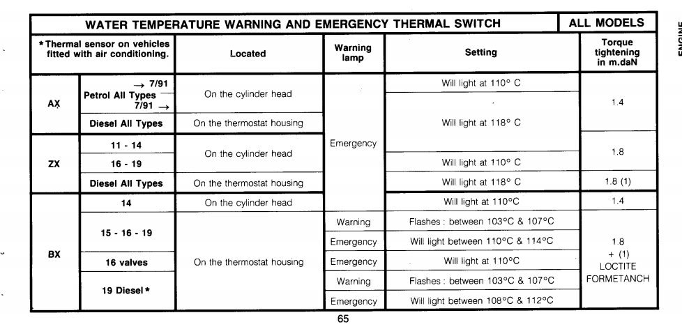

However, Citroen's mechanic's reference booklet
Private Cars 1992 050920 for AX ZX BX XM
has these pages:
Haynes: 79-82°C
has these pages:

Sorry, I've changed the thermostat to an 82 today, that's what I meant. I had changed it previously to an 88. Now the car has an 82 in it, to fit with the lower temp thermo-switch for the rad fan.Dave_16v wrote: ↑Fri Oct 29, 2021 4:57 pm
Maybe I have misunderstood but in the OP, it reads both the old and new were 88c, ie.like for like opening as you stated at 88, not 82. Isn't that why you questioned the bx16valve site info where it mentions 82c below?
The problem still persists, and I've found this site: http://bx16valve.com/technical-info/coo ... -16-valve/
It claims the thermostat is supposed to open at 82C. Is this true?
If you have reduced the fan switching criteria, the stat opening point should be reviewed. In other words,if you have put the same value back in as you originally stated, one stamped lower should be considered.

I have just one at the moment, but I will be fitting a second one using the schematic I believe you gave me.
The radiator is still the original. So just to confirm, does the half-empty, squeezable hose coming out of the rad mean the radiator is at fault?
