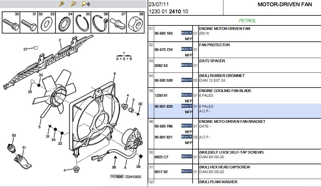

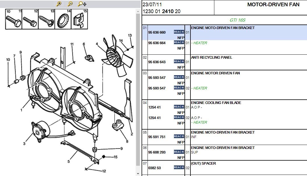

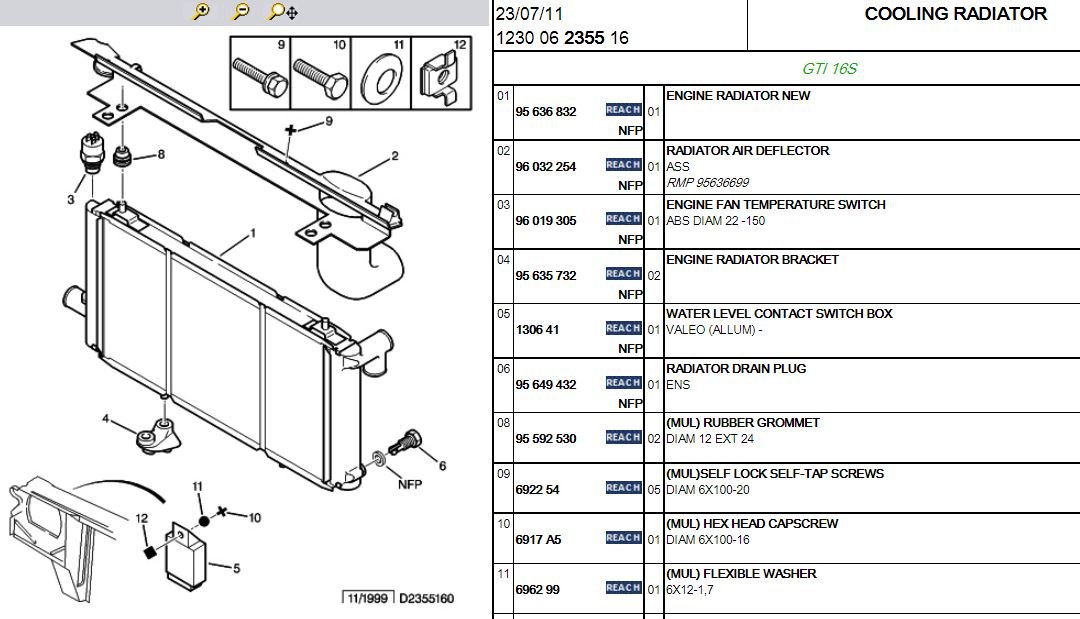

Went back to Parts, and 16v models are shown as having wide radiators and twin fans:
Other petrols (so that would include GTi 8v) shown with narrower radiator and a single fan:
. . So, to find a GTi 16v with only a single fan is odd, and doesn't seem to make much cooling sense.

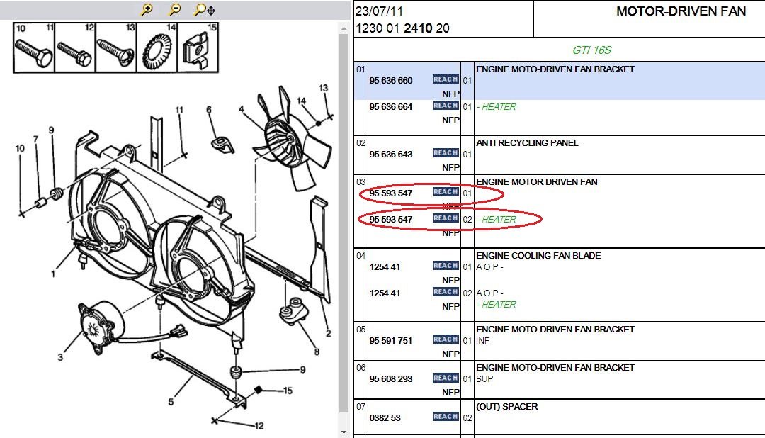

Just noticed that the same part number (for the fan motor) is shows as qty.01 or qty.02 in the parts listing.
Flipping the Parts page into French shows "Heater" as "Climatiseur", so that would be the AC option.
