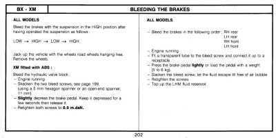

Re: Adjusting ride height on normal suspension setting
This is the official way to bleed the braking system...
. Source: Citroen 'Private Cars' booklet, 1992 CAR050920 p.202 (AX, ZX, BX, XM)
