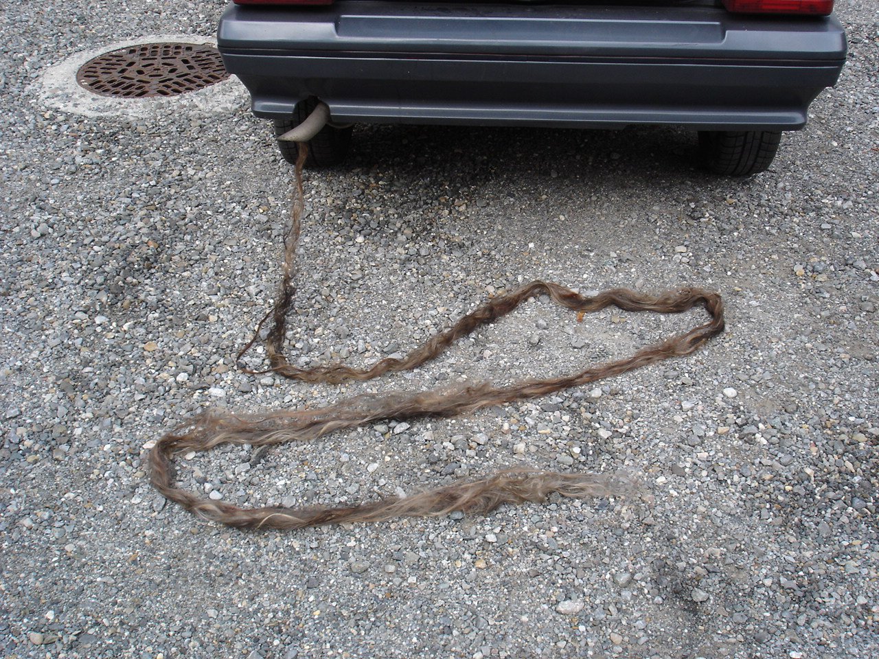

The cross box seems to be an expansion box with the input gas having a perforated tube into the silencer, this tube may or may not have some insulation around it but it just vents into the box and finds its way out of the exit connection. I presume that removes a bit more noise than a straight through/sports silencer whose aim is to produce the minimum flow through without worrrying about higher noise levels.
The rear box is a straight through design but it is packed with fibre glass as well.
Noise levels do seem to vary between makes. The Walker front pipe and box was the quietest I have had. Some makes seem to resonate more than others and the booming can be tiresome on a long journey without a good powerful radio to drown out the exhaust.
On my current setup the exhaust noise is quite well subdued and road and wind noise are both more obtrusive.
None of this makes it easier for Deltic to solve without investing further dosh in what may be a vain attempt to improve things.
