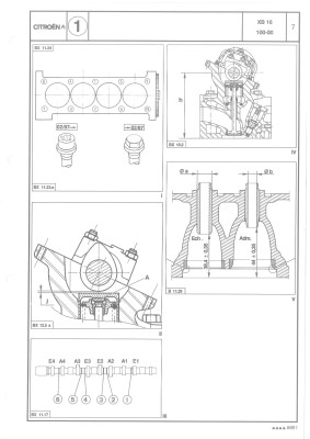

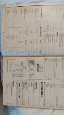

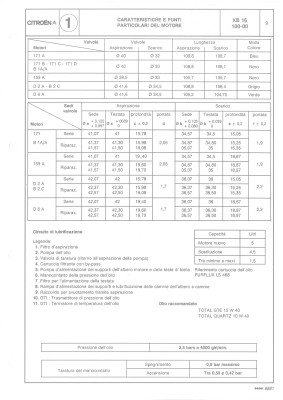

Hi, I found this data from my manual, I hope it can help you. The XU9J2 engine is coded as D6A.
