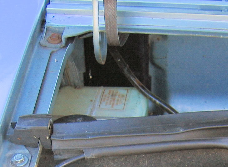

I had this on the GT. We tried to find the lower end of the front o/s drain tube and ferreted around inside the door pillar as much as we could, via the plastic plug at the bottom, and the door wiring gaiter, as that's where the tube appears to end up, and there are drain holes at the bottom of the pillar. However, all we found was a large pile of flakey rust. By that time we had removed the lower end of the drain tube - big mistake
as we couldn't find out how to get it back.
However, we re-routed the pipe through a hole in the black plastic inspection plate (?) in the bulkhead and allowed it to drain naturally there. Works a treat, although wouldn't win any brownie points in a concours event...
There seem to be openings from the door pillar into the car higher up, so I can only guess that the water couldn't escape naturally through the door pillar because of the pile of rust, and backed up into the car. This might explain why yours has got worse over time.
This diagnosis is probably a load of old tosh and I'm sure someone will correct me, but the workaround works a treat!
As an alternative to Tom's hosepipe method, try opening the sunroof, then trickling water from a small household watering car into each corner. You should get a small puddle under the car at each corner, except where there is some sort of blockage. And you don't get wet seats (unless you've got the shakes...)
This picture shows the bodge (although was taken for something else so isn't too clear - will take another photo if you like)
