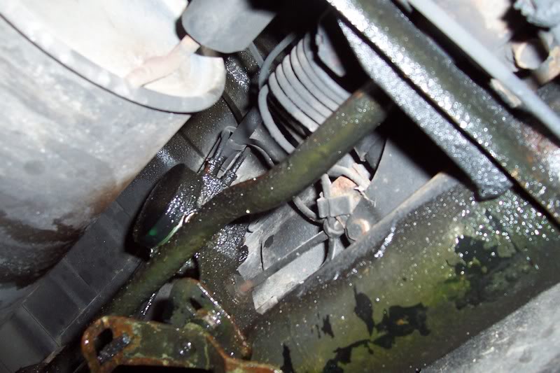

Can some one remind me what the height corrector looks like? :oops:
Pretty sure replaced one some time in the distant past just cant remember for sure what it looks like.

Post by jeremy »
Disc like thing with pipes coming out of it - have a look at the back one - its the same but easier to see. Follow thin rod from anti-roll bar.
kiwi
Posts: 2380
Location: Nouvelle Zealande
Post by kiwi »
Is that the thing with the rubber caps?
aye, thats the one mate!
mnde
Meteor Man
Posts: 1453
Location: Aldershot, Hants
Post by mnde »
Behold the very beast
(My leaky rear h/c)
