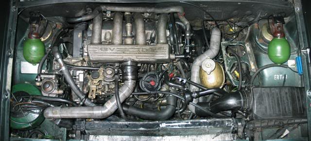

^^ ^^^^bx>
Nice work with the intercooler! Is that an auto? Cant see the kick down cable?
Blimey, thats an awful lot of effort for an extra 20bhp!!!
It's more the torque and wider scope for tuning that make the D12 a good engine really....although I'm not a big fan of the heads..
Spotted a couple of things, where does the battery end up? & on the far right hand side, that blue thing, is it a fuel saver device?
Battery stays where it is, it just isn't fitted on this one!
The blue box is the glow plug relay unit..
