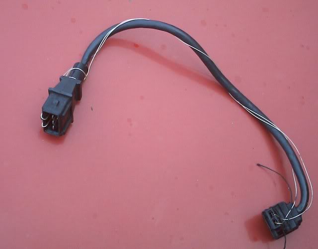

Also check the short cable which connects to the sensor for good continuity. I had a poor ignition problem which I eventually traced to a high resistance of abut 10 Ohms in this cable, I bypassed the high resistance with a wire and the problem was cured.

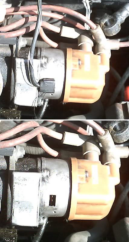

This is the short cable that connects to the magnetic sensor on my 19TRS. As you can see the small connector is a moulded single piece connector. Could you possibly post a photo of the sensor connector on your GT as it appears to be different from the TRS. You can see the two wires I used to bypass the high resistance fault.

adamskibx
- Posts: 950
- Joined: Fri Jul 22, 2005 9:26 pm
Thanks ellevie. Great pictures, but oddly it started instantly when I went back to it yesterday! However, thats not to say things are going well
