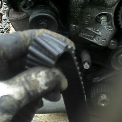

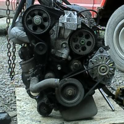

For instance: This belt on a 1.9D 309 looked fine. I was contemplating not changing it, but being as the engine was out anyway, it was 20 mins to change it:
Once removed, it was obviously well past it's best. You can clearly see the beginnings of root cracking on the tooth that I'm bending:

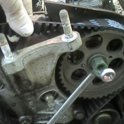

New belt fitted and tensioned:
After running the engine for a bit, and driving it up the road and back, the new belt looked exactly the same as the old one did while installed.
When it comes to a cam-belt, if you've any doubt about it whatsoever, change it. There's not only the fact that it'll be a new belt, but new belts are also invariably better quality and less likely to skip/jump/snap than an older one that may be low mileage, but been on the car for 15 years.
