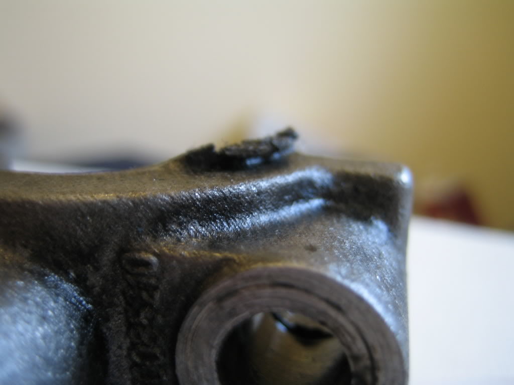

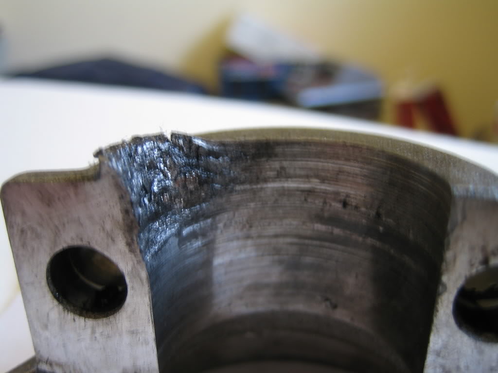

Tonight i took the rocker cover off, cleaned that up a bit, started getting the gasket silicone off the rest of the cam bit of the engine & noticed on the end bearing cap near the cambelt that there was something sticking out from it.

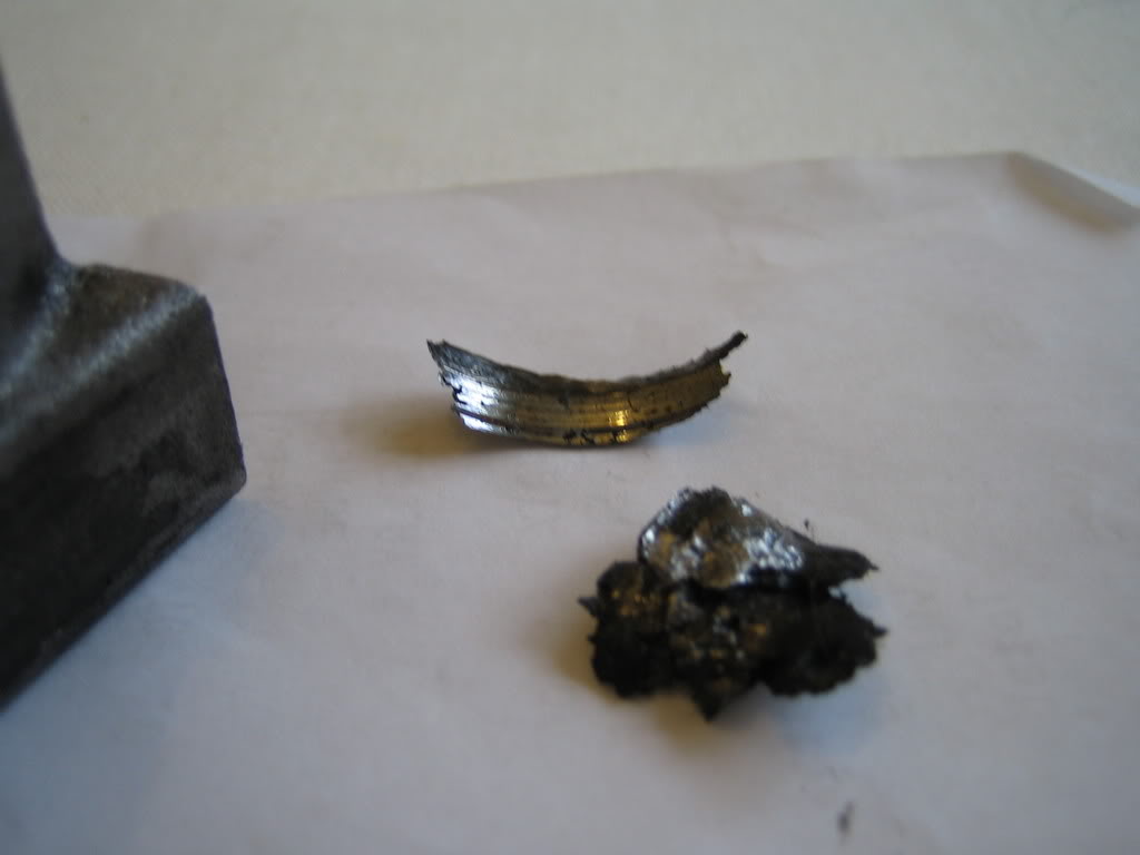

So took the bearing cap off & to my horror it would appear that the bearing cap has gotten damaged & this has caused it to rub onto the actual cam itself which has cut a thumbsized width out of the cam. There were a few largish bits of metal that i pulled out of the cam as well.
This doesnt look good???? what are my options regarding this, can i just refit the existing bearing cap & due to the damage wear on this & the cam then it probably wont foul each other anymore?
or should i replace the bearing cap & also replace the cam???
I took some pics of the bearing cap & the bits of metal i pulled out, didnt take one of the cam as the light is a bit shite, but will take a photo tomorrow.

Is this what happens when someone bodges repairs after a cambelt problem resulting in a broken camshaft.
Is this bearing ca[ from another engine - so not line bored etc (The wear surface in the middle of the cap - with dirt either side suggests that it was only contacting on that part.)
As there is no bearing fit - there is no proper lubrication as the can be no proper oil film. Partial siesure has taken place and basically the camshaft has skimmed a layer off the cap which is some of thr rubbish you have found.
Looks like another head to me with a really good clean of the rest of the engine to find any other bits there may be.
Line boring - the name given to the process of boring the bearings and caps - assembled - so that an accurate hole is made in all caps - for the camshaft. This means that bearing caps cannot be interchanged between engines and the only repair can be made from a blank - which then has to be line bored.
