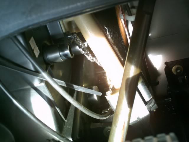

The heater control on my 19TRS was stuck in the half way position for ages until I learned about the valve trick on this forum. I could turn the control either fully on or fully off but it would just spring back to the middle position. If you place a mirror down around the clutch pedal you can easily see the valve. You can use your right hand to reach up and wiggle the valve whilst assisting the operation by wiggling the heater control with your left hand. When I took these photos yesterday I hadn't used the TRS for some months and it had seized up again, but it was a simple matter to just reach up and free it using the valve. It seems it's a case of "user it or lose it".

That sounds about right from my experience - themain problem is relocating the clips behind the panel. The other statistic about that job is the number of swear-words it provokes...If you're VERY patient you can get it in without taking the dash out. Last time it took me about 3 hours to get in.
Mutz - if you can move the valve as pictured in the post above, the problem lies with the valve. If the valve moves but the control knob doesn't, then you'll need to look at the ventilation panel. Are you in West or East Sussex?
