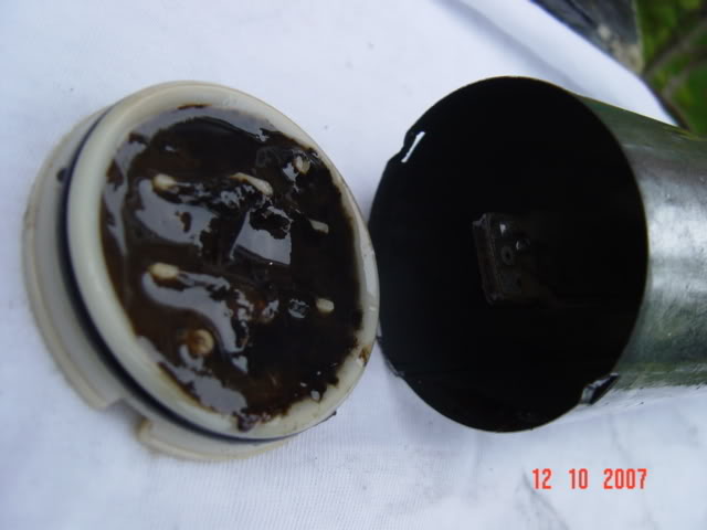

Hi Folks,
I removed and dimantled the sender unit in the diesel fuel tank to rectify an erratic gauge reading "Will report on this in another thread".
When I removed the bottom plug, I was confronted with a blob of black jelly like in texture material. This fell out complete and intact when I turned the plug over.
I have carried out this task before, but never come across this.
Has any one met this type of blob before ?
Is this the dreaded Fungus I wonder ?
prm
Posts: 192
Joined: Tue May 01, 2007 7:54 pm
Location: Surrey
Post by prm »
No doubt at some time there’s been water in the fuel tank and is contaminated by microbiological fungi – black sludge.
Bacteria enters the fuel tank via vents and during refuelling, with any water present, this contamination can increases rapidly. Especially prone on diesel tanks.
If left for some time, this can produce an acidic liquid.
To avoid removing the complete tank, try raising the suspension to highest level, support the rear end, then fully lower. This should bring most of the sludge into view via the tank sender opening, to vac out.
Might be worthwhile giving the tank a dose of water dissolving/injector additive after any cleaning.

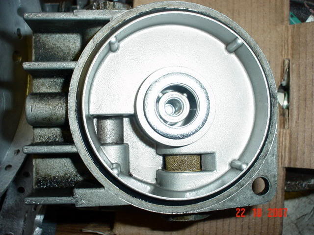

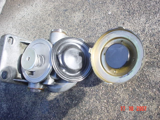

Removed the Bosch filter housing, the filter was clean, no contamination at all.
Filter back on the car, difficult to prime, engine would run for about 2 mins, then stop !!.
Filter housing removed again and dismantled, revealed a floppy crazed and sighly holed diaphram, not bad I suppose after 21 years..
Good job I did this check, as it could have left me stranded at any time..

Found the Bosch part no yet on the membrane/diaphragm Brian ?
Brian
Posts: 441
Location: Bedfordshire UK
Post by Brian »
Hi Anders,
Well to be quite honest, I took the Roto Diesel filter housing, from my Visa D which I am still restoring, and fitted that which works Ok, although the filter is a lot smaller.
I will try and find out if the diaphagms are sold as a spare part, I doubt it though..

I think the early type Bosch (Purflux) filter is better than the Lucas one, as it has an additional bead type filter on the outlet port. (Picture Below).
But it means making up a blank out of suitable diesel resistant material in place of the diaphagm and clamping back the existing cover to form an airtight / leakproof joint.
