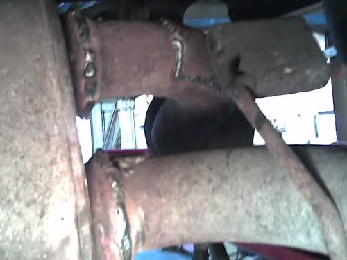

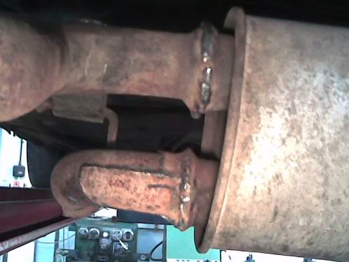

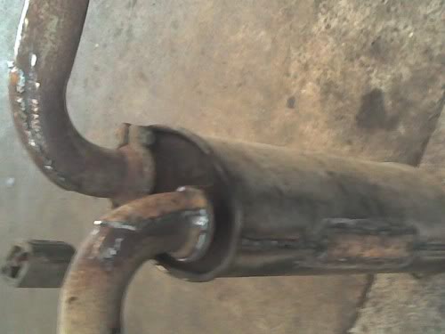

Oh dear. If it's illegal to weld anywhere on an exhaust system, I must be in super deep trouble:
Utter rubbish. Weld anything you like. If there's a big explosion, or the car catches fire, then you know not to weld there again.
As anyone who knows the BX exhaust system will realise, the one on my motah is now 1 piece. You remove the 2 bolts to the turbo flange, and the whole thing comes off in one go.
Doesn't leak though. :wink:
