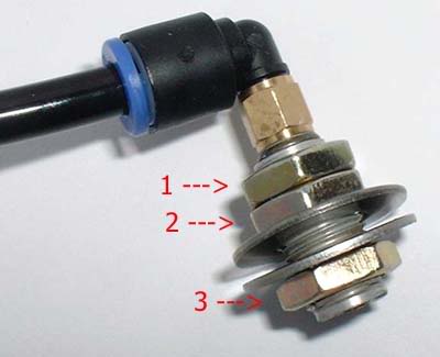

This:
is the sort of fitting I'm thinking of (the plastic bit, obviously) but I don't know what they're "officially" called. I've never had to buy any either, so I've no idea what sort of supplier would have them, sorry.
But... I'm fairly sure they were available in 0.5mm steps, so 4.5mm would be an available size.
