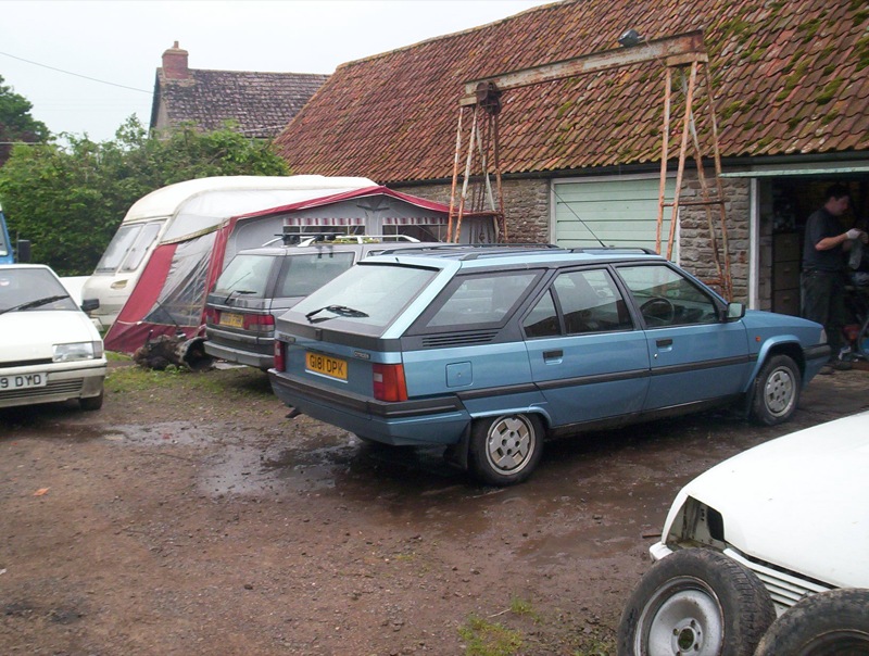

I've pimped my ride! Thanks David, thanks Doc. I went west this weekend for David to sort out my Octopus - which he did with the bits we had to hand, as the correct part seems elusive - give it a service, and make some minor modifications that really do improve the BX experience.

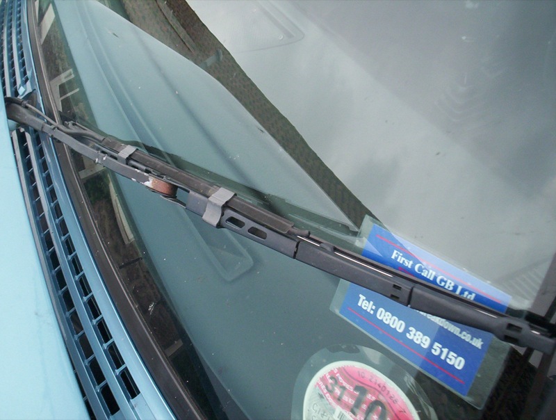

Next up, the crappy BX windscreen system. I like the idea of a spray up the wiper arm, but the BX implementation is rubbish - holes in a bit of washer hose, indeed. Mine was particularly crappy, being a bodged together bit of white washer hose held to the original piping by - get this - the insulation off a bit of mains cable. It looked awful.
If, however, you happen to have a pile of spare Peugeot 405s hanging about the place, the solution is obvious. Any BX that's ever been anywhere near David's house will probably look something like this:
And the piece de resistance - a full set of Speedlines. Oh yes. This idea had been suggested to me and I wasn't going to bother until Pindimar posted pictures of his identical car - so it's all his fault, clearly.
You can accuse a standard BX on 165s of being under-tyred. 185s do the job nicely though :)
