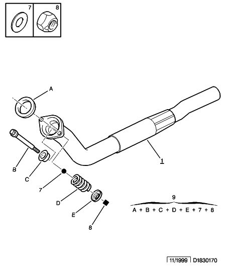

What a load of chattering housewives! I thought somebody ought to stay in touch with their masculine side and check the technicalities. Well, it's certainly a front pipe and it's certainly rare, but no way is it for a 16v. It's for a carburettor 1905cc. Check out the part number .

Looking again at the photo it seems to be missing the integral box for a 16v which wasn't present on standard carburettor models, so well spotted Brian!Brian King wrote: but no way is it for a 16v. It's for a carburettor 1905cc. Check out the part number .
Don't think your caviat Tim, "Sold with no reserve, please check this will fit your car as NO REFUND OR RETURNS are offered." , will work if you are misrepresenting what you are selling as how can someone check that it "does what it says on the tin" on a BX16v before they receive it
- Posts: 7279
- Location: RCoBerkshire
Your listing doesn't highlight that it is only for catalyser version and there were very few of these that got to the UK market as I understand it. So chances are that it won't fit if the buyer is unaware that this is what it is for.
I think you need to check up with Citroen exactly what your part number refers to unless someone here is able to cross reference the number quickly.

1230 06 1830 17 EXHAUST FRONT
1,905L AND 4X4
01
96 076 276
NFP
01 EXHAUST FT PIPE
- CARBURETTOR
01 - INJECTION
07
1712 28
02 PIPE WASHER
DIAM 9X21-2,4
08
6935 86
02 SELF LOCKG NUT
DIAM 6X100-5,5-10
09
1798 75
01 FIXING KIT
51
96 061 798
NFP
01 EXHAUST FT PIPE
- CARBURETTOR AND (XT) AND RIGHT HAND DRIVE
01 - INJECTION AND (XT) AND RIGHT HAND DRIVE
