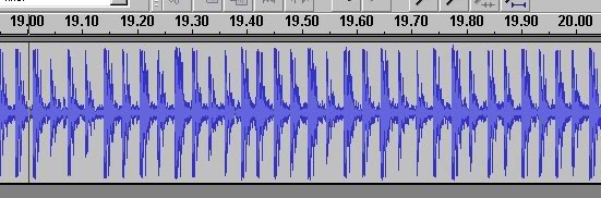

Here's a fairly simple way to get a reasonably accurate estimate of the RPM without a tachometer.Aerodynamica wrote:had a check of the idle speed for mine - 650 rpm. I think this is what it was set to but it's hard to be certain as the tacho on the Mk1 is a bit vague at less than 900 rpm (there's no reading below it!!)
1) Tune a radio between stations on the long or medium waveband and turn the volume up to hear the sparks.
2) Record this using your mobile or tape recorder etc.
3) Transfer the recording to your PC so the sound waveform can be displayed. The sound editor "Audacity" available free on SouceForge is suitable.
4) Count the number of spark peaks in a period of one second to give the spark frequency.
5) The RPM is then 30 times the spark frequency.
For example the recording shown below has a frequency of 32 sparks per second which equates to 960 RPM.
