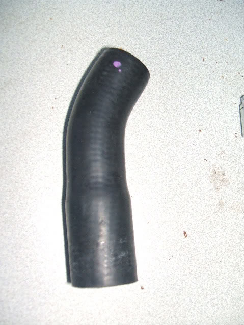

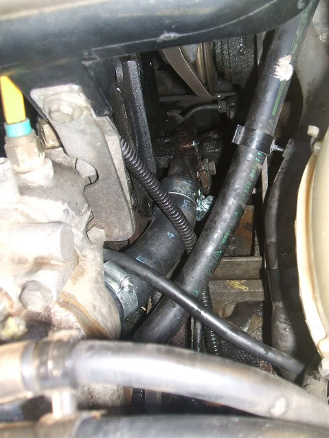

I've just tried to get a replacement for the small bit of water pipe that goes between the thremostat housing and the heater system
I tried to get some piping from local car shop but biggest piping thay had was only 19mm I.D (the bit came off is about 23mm)
can this be got from Cirtoen or can i get this bit from an other sorce ? :)

I managed to get the part
I gave Evans Halshaw of Doncaster a call, their Parts people : 01302 329303
the guys are great they knew just the part that i needed and they could get the part in the next day and that they would call me when they got it
at 8.30 this morning i got the call and picked up the part and at £5.43 not painfull
all sorted and back in place :D
