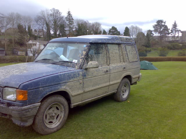

mat_fenwick wrote:[img]Non-BX%20Dirty%20vehicle%20image.[/img]
Disqualified!
Plus it's a Land-Rover. It's against the law for them to be clean.

DavidRutherford wrote:Plus it's a Land-Rover. It's against the law for them to be clean.
Agreed. Actually I'm feeling very anal about the BX after seeing these photos. I don't wash it that often (in fact the last time was before the 2007 National!) but if they've been out gritting I will spend a couple of minutes with a hosepipe rinsing the salt from the wheelarches and sills.

Good dirt trackin' Matt, but disqualified as DR says!!! :lol:
Right, I'm off to find a ladies mud wrestling pit and get me car uber dirty!!! ( :oops: on the outside :roll: )
