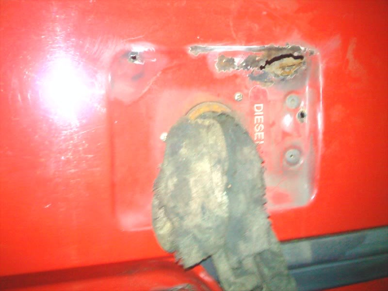

Had a poke around the fuel filler on the BX last night, and this is what I found:
It's going to be tricky to make up an invisible patch repair, so am on the look out for a decent panel from a scrapper. But I'd guess that if the car is low value enough to be scrapped, it's probably in similar condition. Maybe I can get a new panel and just cut out the section around the flap.

At least it's diesel, I wouldn't like to tackle that repair round a petrol one :-(

True, although I may have to drop the tank anyway - at least the auxiliary tank. I would put money on the rust having spread a lot further on the rear, underneath the 'protective' coating than on the front. So I need to know how much to cut out or be able to remove any rust on the rear face, plus sealing the welds afterwards. Fortunately in a rare moment of foresight I didn't fill the tank up before taking it off the road (or is that because I'm skint?) so I may just be able to remove the auxiliary tank without spilling too much fuel.
It's amazing how much mud has accumulated there, despite regularly hosing it out. I'm going to buy and angled lance for the pressure washer to enable me to get in there better in future.

could hack a bit out of a wing for you at the weekend if it helps? I have the old wing off the valver on the floor, it's a bit twisted, and obviously from a hatch not an estate, but the actual filler bit is ok. It is in blick though, not red..

Cheers, Kitch has offered the one from G-SEG but seeing as he'd have to drain the tank and cut it out before properly seeing what the rear surface is like, yours may be a better bet? I was thinking of a section a couple of inches bigger than the flap, and just welding that in - if that's straight and rust free on yours I'm interested!
No worries on the colour - I was even considering giving it a coat of paint after welding, that's how thorough I am!

If you're going to fit a piece have you got a joggler? Thet are used to form a recessed lip on the recieving panel for your new piece to fit flush into. I have the one below somewhere (without hole punch) that I could post to you to try?
http://www.frost.co.uk/jogglers.html" onclick="window.open(this.href);return false;

I've never used one TBH, I've just butt welded pieces in where they needed to be flush, and usually lap welded if it's underneath and I can get to both sides. Joggling sounds a lot easier, so that would be very handy thanks - I'll send you a PM shortly :)
