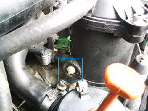

And it hasn't stopped there: Replaced fuel return pipe, camcover gasket, leak off pipes, new fuel filter, new rear shock absorber, dash bulbs.... and it still gives me grief; this little baby is leaking like a sieve:
(Not my 806 but a Googled XUD image for ref.)
And the seal between plastic housing and alloy pre-heaty thing above thermostat housing is weeping like a failed Olympic rower...
Kermit to the rescue: Post Office permitting I should receive a replacement filter housing with non-leaking seals and fit it on Wednesday. Fingers crossed.

I wrote:you'll see a white plastic thing on the side near the bottom - this is a valve which allows fuel to flow through a heat exchanger underneath the filter in cold weather. The O ring on this can fail and allow air in.
Ah, so I was partly right - you're getting diesel leaking out rather than (or as well as) air in? You'll have replaced most things which could cause a leak, so hopefully should give you piece of mind (looking on the bright side...)

Well, here's hoping. If there is another air leak it'll be the bulb or a particular long return pipe that runs from the filter side to the pump side, below the level of the injectors (Peugeot sourced it for me - dunno what it's called) and I have a new one of those to fit at the same time as the filter housing. I really hope this fix soves the problem!

First indications are - thanks to replacing the whole fuel filter housing (thanks Kermit for sending the part so quickly!) - are that we located the problem accurately (another thanks to Steve - sdelasal) and the car starts, idles and runs fine. No stalling or tricky starting. A round trip of around 33 miles tomorrow should reveal the 'truth'. Feeling a bit more positive now. :)
