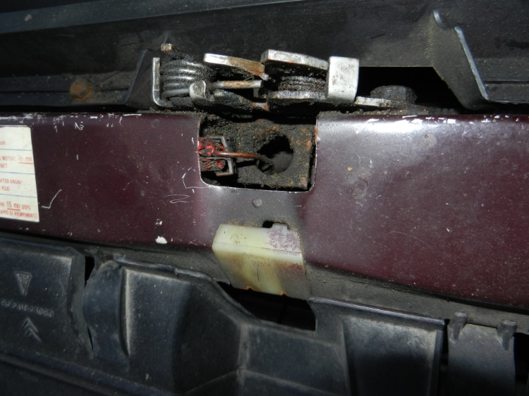

Look what I found! In a collection of bits I didn't realise I had - not sure where it came from but it's nice to have a bit of luck like that! I once found a brand new genuine Citroen windscreen wash motor I had forgotten about that came from the boot of a scrapped car, along with a few other spares. Unfortunately I found it 2 weeks after buying another one when the motor failed
Anyway, you were saying? The bonnet switch often gets corroded from road spray, but may respond to cleaning up and protecting with silicone grease. I've got a feeling that it's the same switch as the boot and handbrake lever, so worth a check as someone may have a spare.

The switch on mine looks like its been pulled up out the hole it sits in and has got wedged into the slam panel, so will have at it with the pliers sometime as its stuck solidmat_fenwick wrote:Anyway, you were saying? The bonnet switch often gets corroded from road spray, but may respond to cleaning up and protecting with silicone grease. I've got a feeling that it's the same switch as the boot and handbrake lever, so worth a check as someone may have a spare
I didn't know there was something for front and rear lights as well. I do light the blown headlight idea though, could maybe make the rear one light up when you've got rear fogs on or selected reverse ?
- Posts: 7330
Re: Mat's BX Blog
Looks like one of the wires has fallen off too, which is the other common problem. Not difficult to sort though assuming the wire hasn't gone green down its full length.

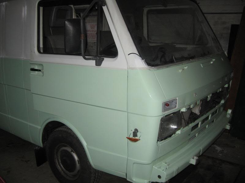

Made a bit more progress on the van this evening too
The paint goes on really well and despite being thinned down from the tin, covers almost completely in one coat.

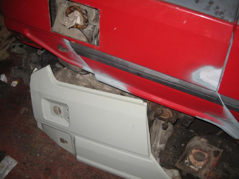

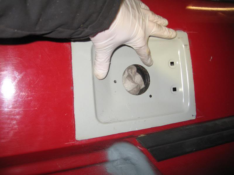

Look what arrived today

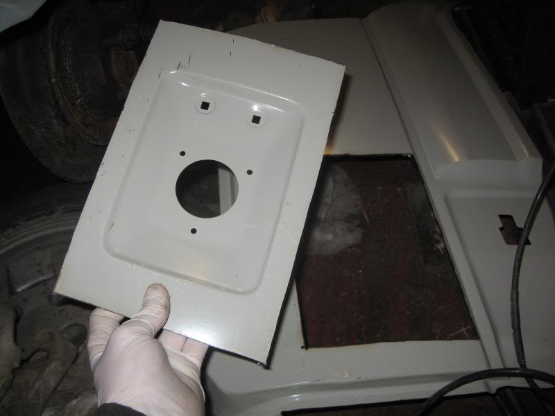

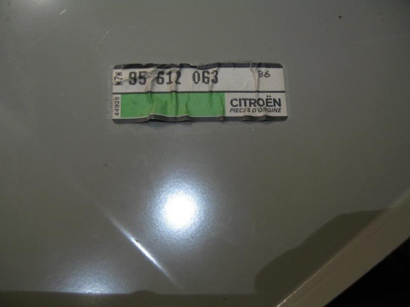

Genuine Citroen panel too...
...which I promptly set about hacking into (I did feel a tiny bit guilty at this point
I joggled the edges of the panel with my borrowed tool (thanks Kevan!) but could not do the top one as the inner wing was in the way so will have to butt weld that.
Unfortunately I prodded at a rusty area underneath where the breather pipe mounts to, and poked right through so another patch required. At least access will be easy with a big hole in the wing!

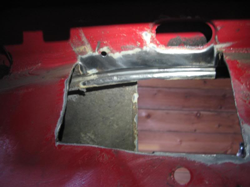

But I managed to spend a few hours on the BX! I removed the boot trim and set about cutting out the hole in the inner wing. What started as a small hole predictable grew, although the main problem was in the seam. I had to chase the rust some way from where it was visible to makes sure there was none hidden between the layers.
I couldn't quite get rid of all the pitting, so have coated everything with Deox gel, then once it's removed I will weld in the outer wing first. That way I can ensure that the rear of the panel is properly painted after welding, as it would be difficult to see whether I've missed anywhere from below. It did cross my mind to make a bolt in removable section in the inner wing, so I can clean behind it more thoroughly
Fortunately I have plenty of genuine Citroen steel to weld in!
