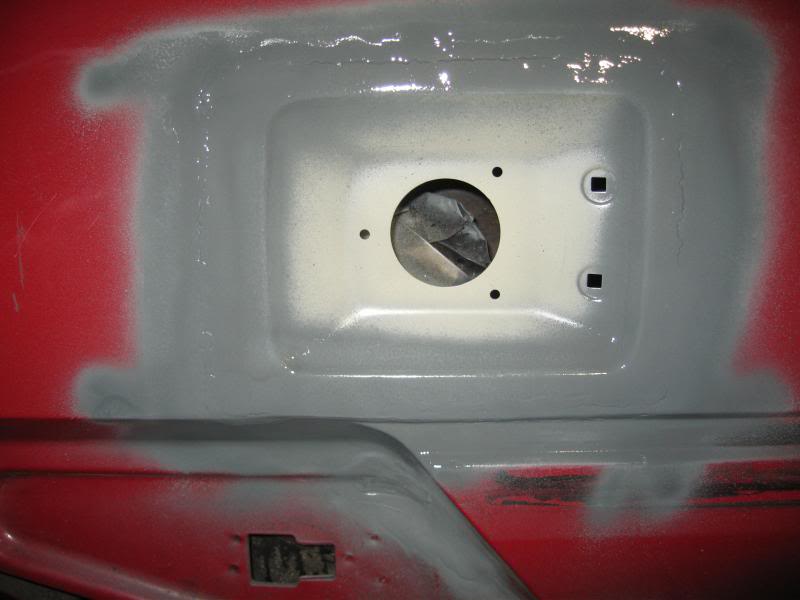

Neatly linking from flaps, I've being doing some weldy weldy tonight on the red BX. I was incredibly nervous before starting - not sure why but perhaps the value of the panel had something to do with it!
Then painted front and back:
Then welded in my access panel (I did weld it all the way around, but the photo is a work in progress!)
Once the paint has dried tomorrow I'll be able to seal all the seams thoroughly, and give it a skim of filler on the outside. There is a little bit of distortion (a mm or two), but nothing standing proud when I put a straight-edge across the panel.

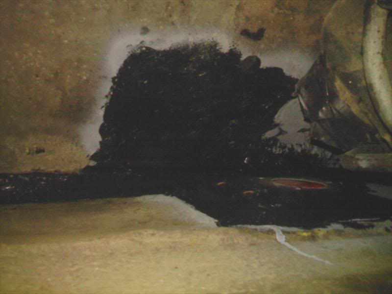

I'd never put any extra underbody protection in that area, so although the rest of the shell is pretty good, this area suffered. Difficult to do with the extra tank in there but I will spray some wax around while the neck is out.

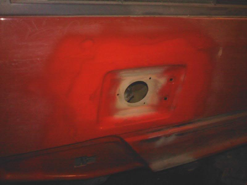

Tonight I sealed the seams, skimmed over the outside of the panel with good old P38, and then gave it a light guide coat to see how bad it looked!
I coated all the fresh metal with Sikaflex to give added stone chip protection.
Still a few low spots but making some progress at least. The MOT is booked for next Tuesday...

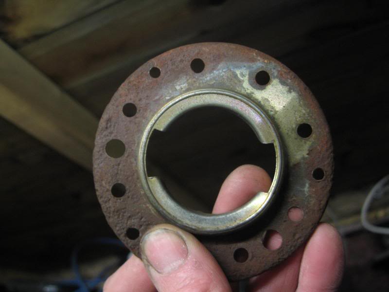

I'm almost ready to put the filler neck back on, so had to remove the rust on the locking flange. Started off like this:
...and here's what it looks like now after a coat of Deox gel:
It hasn't got into the pits as much as I'd like, so will have to give it another coat. There is a liquid form you can buy for immersing small parts like this into, so would hope that does a better job.

Just stick it in some malt vinegar overnight Mat.
Re: Mat's BX Blog
You need an ultrasonic cleaner ;)
