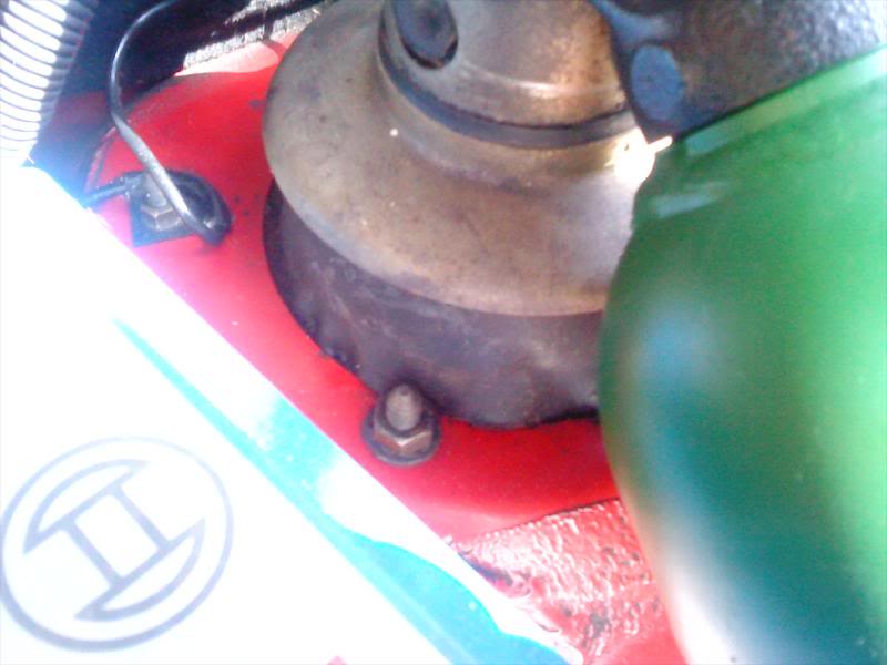

Cheers, I've picked it up now and the only advisory was that one of the rubber strut mounts had deteriorated slightly. You can make it out on this photo where it's come away slightly.
I'd rather know than not know. IIRC it was not unknown for them to separate on Xantias and XMs to let the strut pop though the bonnet!
Re: Mat's BX Blog
Very true. I've even seen a C6 where that had happened!

You could make a cage that surrounds the strut top and utilises the strut mounting bolts. IIRC our Swedish/Norwegian cousins use something similar on their XM's.

A strut brace is something I've been thinking about for a few years, but the only way I can think to make the bit which fix to the strut tops is by using my cutting torch. I'm not sure my hand would be steady enough for the accuracy needed. When I change them would be the ideal time to make a template though.
I'm not sure whether they fail catastrophically though - I remember doing the ones on Timex of which at least one had a fair amount of play IIRC. So it may be a fail-safe design.

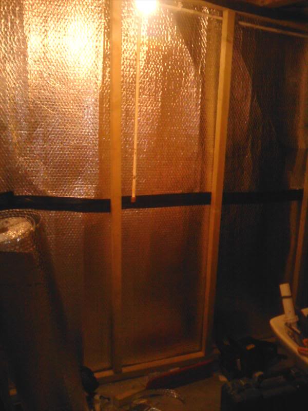

After my night off yesterday it was back to it this evening - pretty much finished the stud walling and insulation in the house:
Washing machine temporarily plumbed and wired in so we can wash clothes! It'll soon be time to put plasterboard up

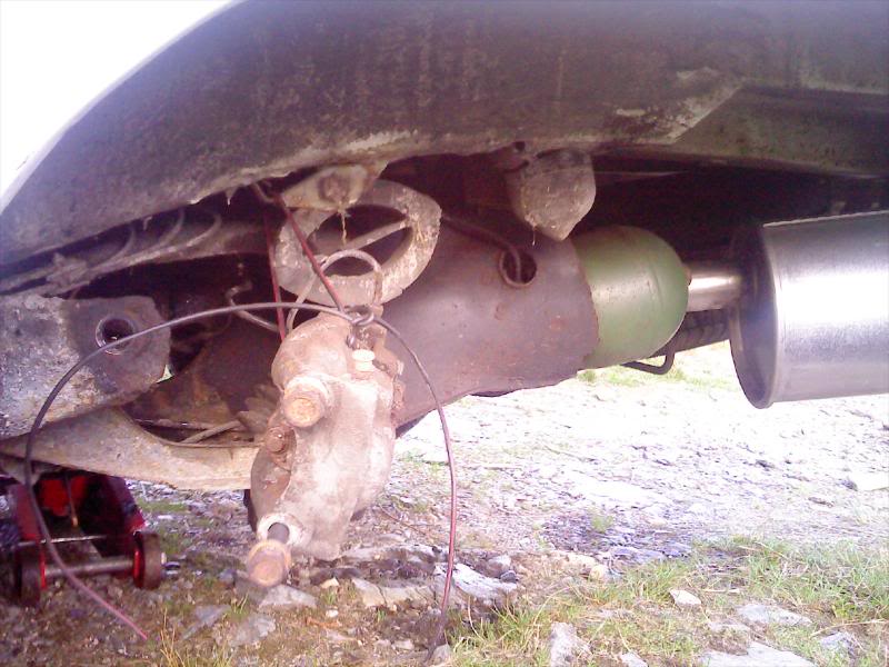

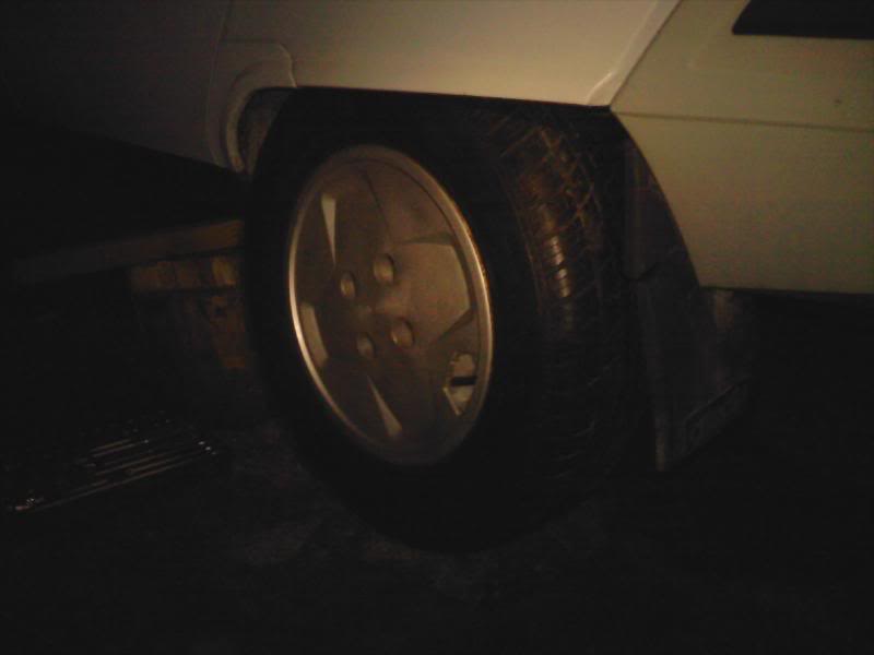

Then freed off and copper greased the rear brakes on the white BX, before fitting replacement tyres all round. It's a shame that the previous set of Michelins had cracked, as there was plenty of tread left.
Also put on the new exhaust, so it'll soon be ready for an MOT.

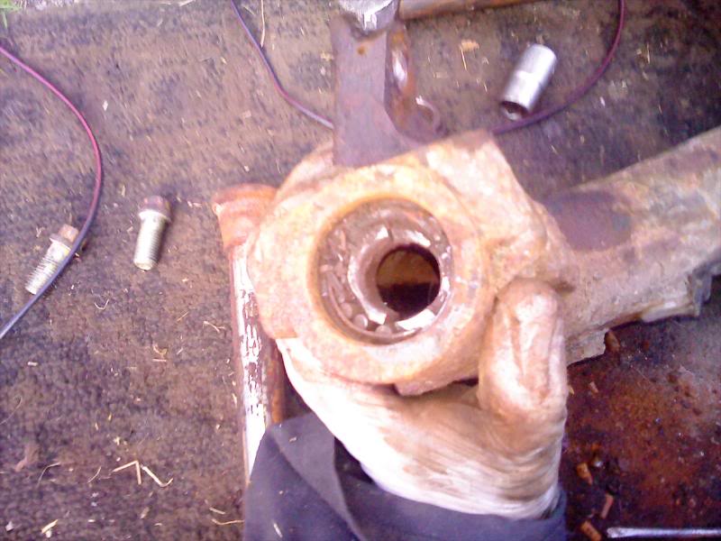

Got the rear arm off no problems...
...and at first glance the bearing looked visually fine - no damage to the seal. But I could feel a fair bit of play, and when I knocked the tube out I could see what the problem was
The inner race had shattered! It could just be coincidence, but this was the side which had a ruptured sphere and I'm wondering whether the lack of suspension meant that more shocks were transferred to the bearing. It would still more more of a rotational force than a direct impact though.
