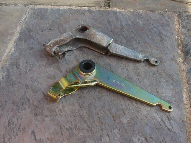

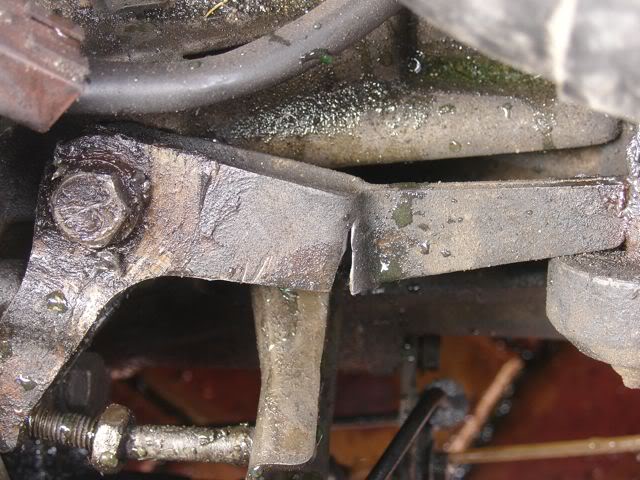

Have you checked the condition of the lever arm on top of the gear box - the one the clutch cable connects to? The one on my Series 2 gradually split about 18 months ago and in the latter stages was OKish when everything was cold, but once warmed up (clutch cable expanded??) I had to ram the clutch hard to the floor to change gear - and then with a crunch...
Photos are old one in situ and with new one for comparison. Citroen part No = 96 134 964.
Just a thought...
Mark T.
Melbourne, Australia
BX16 TRS Auto (Series 1)
BX19 TRS (Series 2)
C3 Pluriel
