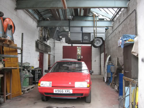

Thanks very much for the info guys and hopefully you will all get rewarded with a photo....however ive never uploaded one before so..(dont worry ive found the sticky)...erm except the creenshot have disappeared
..hmm..
my god i think its worked- at least in preview. Wow...even a total dimwit like me can do it...there you go behold a BX mark 1. Very rare of course, almost as rare as a flying h van...oh wait...
Apparently the mechanic Graham Morton (formally of M&M Motors) has worked on many of them before and knows his stuff very well. He is also an excellent welder...which is gonig to be exceedingly useful.

Well the front is the best view
no rust with all that plastic bonnet.
As for the sills Graham might actually have some himself. He couldnt remember if he scrapped them or not
. (ill keep you posted Todd).
I would post a pic of the sills but theyre still loading....yet they loaded to facebook fine...
Don't worry im not going to start bombarding you all with photos- ha ha ive got loads.
