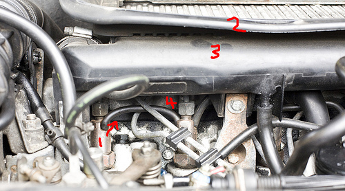

I think I mean the rocker cover gasket. It runs horizontally along the top of the engine? Yeah, thanks for the terminology hints and tips, I'm not bad, but I've a long way to go. This is the first car I've ever really worked on.
1_1 by Wooscary, on Flickr
Number 1 is what I'm talking about. And I guess that putting a new one on is a case of removing 2, 3 and 4? All looks fairly straight forward, just allen key bolts and taking off some hoses.

Any motor factors should have the rocker cover gasket. Actually there aren't any rockers underneath so pedantically it should be called the cam cover...
Held on by three 10mm headed bolts (don't overtighten on reassembly) but there will probably also be a few hoses clipped to it and the breather hose connected to it.
You don't have to remove 2 (intercooler seal to remove 3 (intercooler), just flex forwards at the back and take out three allen bolts. At the front are three 11(?)mm bolts - a little tip to make it easier next time is to enlarge the holes in the plastic intercooler housing to slots, so that next time you have to take it off you can just slacken off the bolts rather than remove them completely (and run the risk of dropping one into the gearbox bellhousing - don't ask how I know...) Also make sure you don't lose the small D shaped seal between the intercooler and inlet manifold (the bit the intercooler is screwed to at the back).

Yes, you need to take those items off, the gaskets are widely available from any motor factors, are there are lots of xud engines still on the road. You'll need to clean up the surface where the gasket fits onto the engine head, be careful as you don't want to damage the surface. Basically you need to remove the residual gasket glue after popping the cover off. Also, be very careful when tightening up the 4 bolts on top of the rocker cover, they can be stripped out very easily, how do i know this

That's fantastic. Thank you gents for your highly useful replies. I reckon this is perfectly manageable for even me.
So aswell as the gasket, I need gasket glue too, and I've got everything else tool-wise, so looks like all that's needed now is some dry-ish weather.
