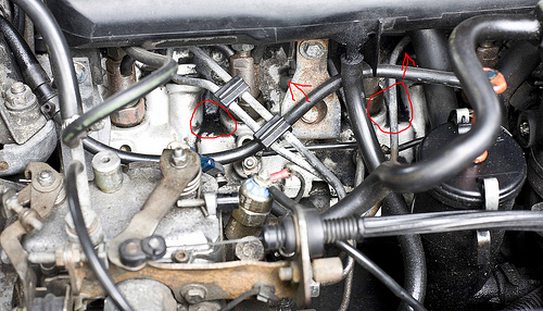

The oil leak is really starting to annoy me, I'm going to attempt some photographs below. You'll have to be gentle with me, as I'm no expert and don't have a Haynes to identify parts/what parts are called. It seems to be originating from what I think is the rocker cover and around the injectors. It then obviously goes everywhere below and behind that point, but I think that's the highest point.
1b by Wooscary
So, if anyone has any thoughts that would be great. Would a oily air filter also account in part for the noticeable amount of smoke when accelerating?

Most likely this regulator has failed causing a pressure build up in the crankcase, No3 in the picture, you'll find it on the end of the intercooler in the breather pipes on the turbo cars. Citroen part number 0361 58 about £30 in the dealers.
That is of course if the piston rings/bores aren't worn out. Gibbo.

Thanks. I'm not quite sure which half of my question you are providing an answer for however. And cannot figure out where that diagram matches up under the bonnet.
Looking at that, the part doesn't look especially hard to fit, and isn't the most expensive thing ever.
Would there be any other symptoms if it were worn rings/bores? The car isn't sluggish, and actually after taking the air filter out yesterday and scooping the small amount of sludge out of the bottom of the box, the amount of smoke seems to have dropped. Could be coincidence of course.
Any other thoughts gladly received. I really want to get this car to 300000 on only engine number 2! :D

It causes raised pressure in the crankcase which blows oil out from anywhere it can get, usually the most obvious being the camcover gasket so oil on the top of the head and down the back of the engine sometimes mis-diagnosed as the head gasket.
As you know a little oil spreads a long way. Gibbo
