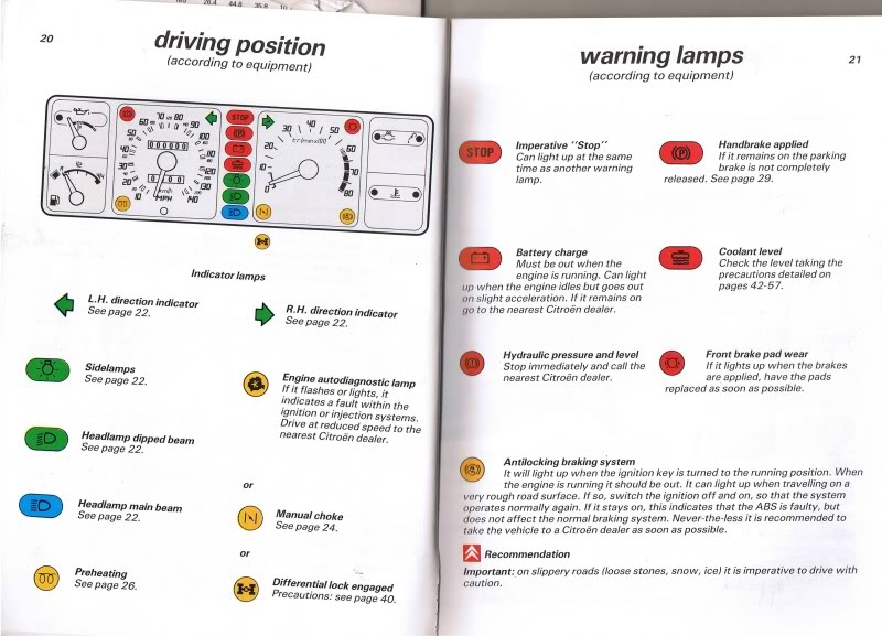

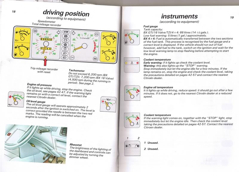

rodney68 wrote:not sure that one is other side near oil pressure gauge this is orange on right near oil temp gauge
Trust me, it is the brake pad wear light. the other light you refer to, is the hydraulic warning light, it warns you when there is not enough pressure, or not enough LHM in the tank.
Hope this helps!

checked on here n found a post with pic of dash light on and yes brake pad light cheers everyone
