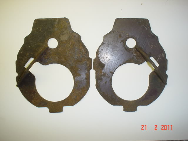

as rmattila says No. 3 is only a support for the tail end of the cylinder,
it odd though that the left and right ones are handed on estates but not saloons, as it should be the same fitting appart from a diferent sized centre form the fatter suspension unit,

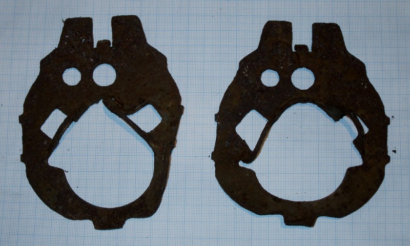

There's a pair I salvaged from a 1990 Van (which started its life as a Break) that was going to the scrappers:
Apart from the deformation caused by the need to use force in the dismantling process, they look quite identical to me. The only thing that comes to my mind is, if you look at the drawing on the previous page, there seems to be only one hole drawn for the hydraulic pipe in part 3, not two as in my photo. This would make the part handed, as the supply pipe leaves the housing in a different direction on starboard and port side strut (towards the wheel on each side - see pic).

i was not refering to the strut gaitor's being handed,
it is the support plat as in the picy's we a talking about
it causes you to need more,
Discoil
