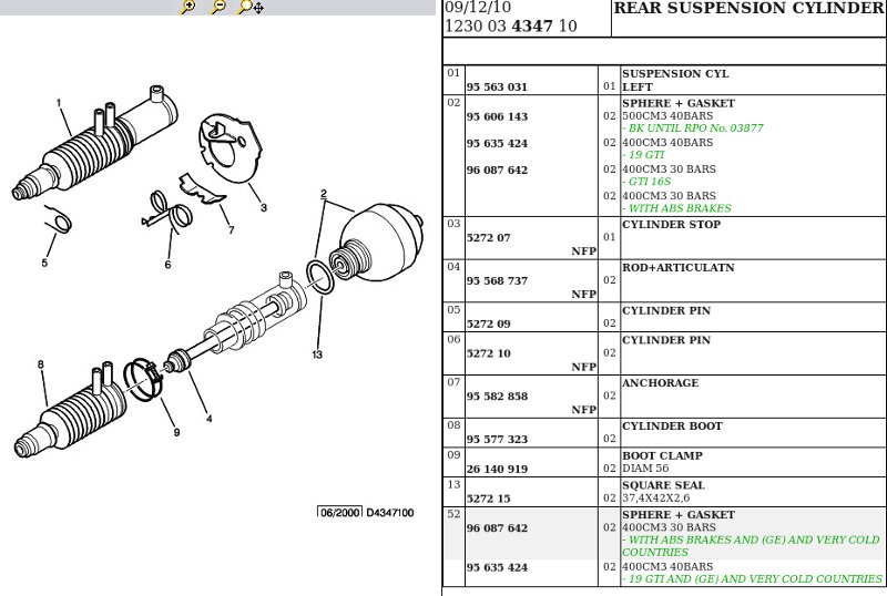

rmattila
- Posts: 412
- Location: Finland
I have never needed to replace one, so can't say for sure, but the old paper catalogue (see below) seems to hint that they would be reversible in saloon, but not in estate?
