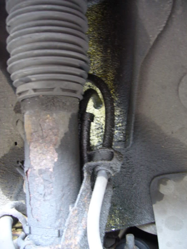

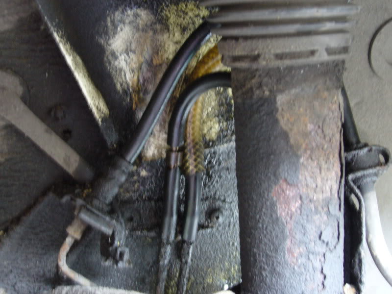

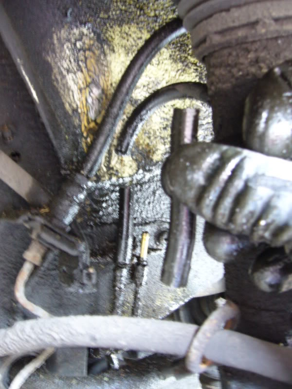

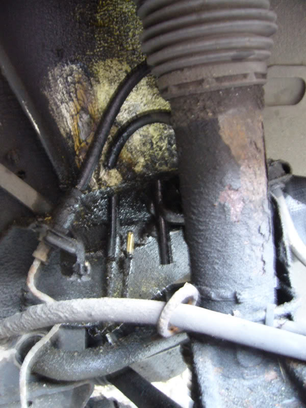

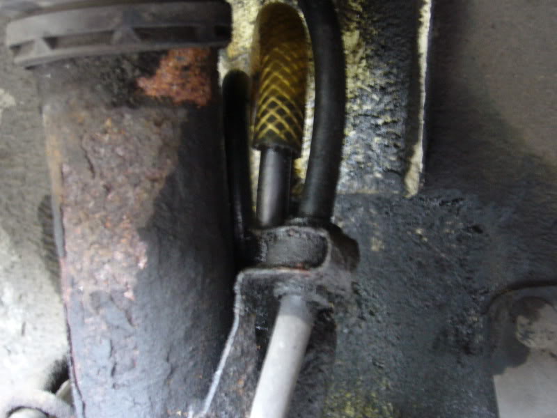

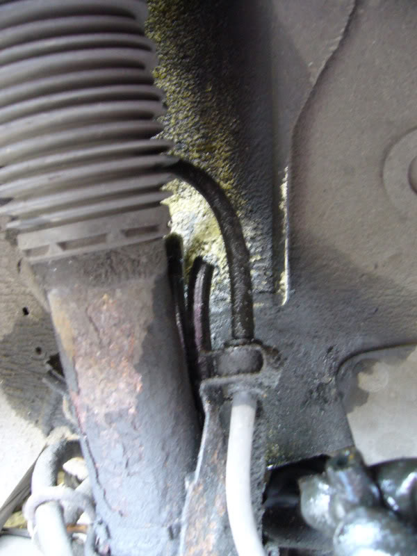

So, a better look at the pipes.
As well as the brake line, there are two LHM pipes that loop up from the back of the strut and down onto the the inner wing...
...or there should be!
Both of the pipes were fractured and separated...
...but one of them had a length missing! The whole loop over was gone.

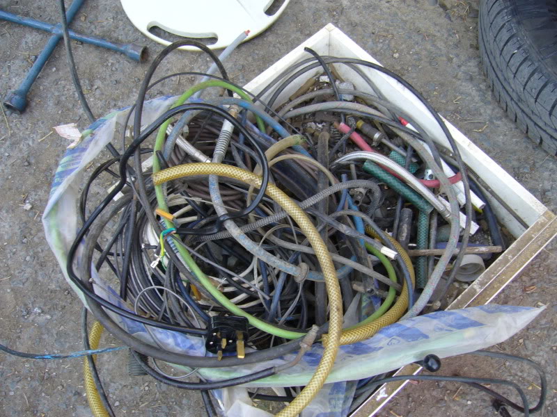

So out with the stash of pipes'n'crap.
I found a nice little brass connector - designed for the job for one pipe...
...and a bit of motorbike fuel line or summert for the other. It's all just pushed firmly together for now; there's obviously no great pressure in these lines so I'm not too worried. The original(?) pipes fitted are clearly too 'hard' and brittle (and slipped off really easily). Where would you recommend I buy new, good quality return pipes?
So, I hope I got them the right way around! Dunno how my suspension has been working, but it has been fine.

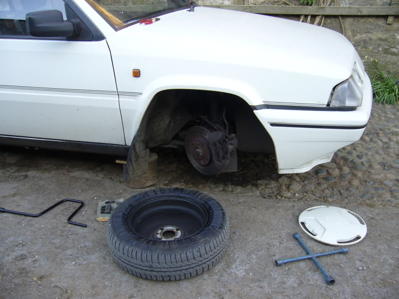

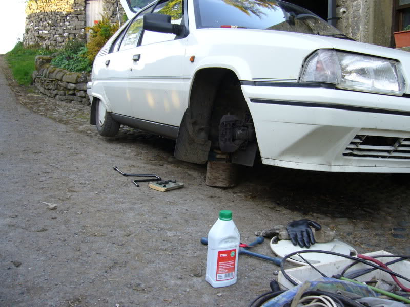

You should have asked Malcolm to send you the front return pipes as well.
One word of warning here though, I wouldn't block the car up under the sill as you seem to have done, the metal here is quite soft, I'd always block up under the subframe, just a bit further inboard from where your blocks are in the first pictures.
