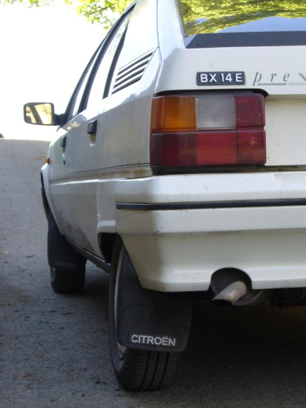

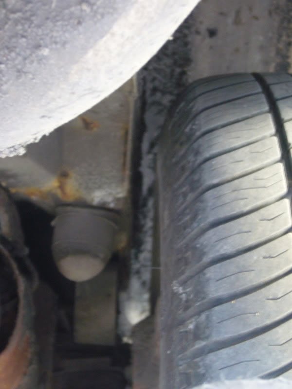

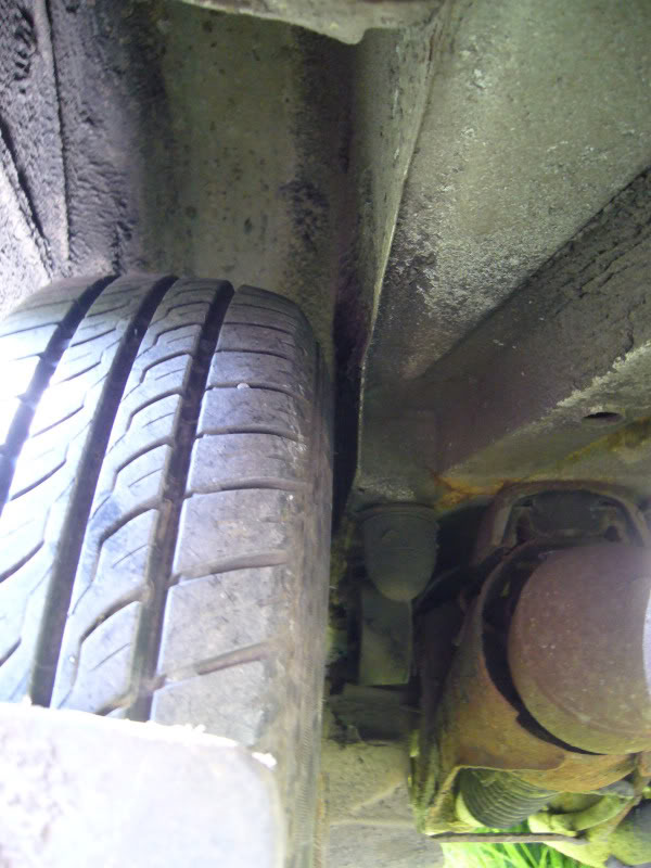

An occasional rear end creak, and a tiny hint of negative camber is leading me to suspect the trailing arm bearings:

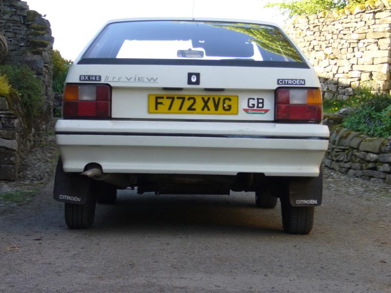

This is with the car set high.
The mudflaps don't help the illusion, but...
I'm sure they're leaning a bit, esp the near side:
I can only just get my fingertips between the tyre and the chassis rail there. Off side:
Did I read there should be about an inch there? Enough to get most of my hand in?

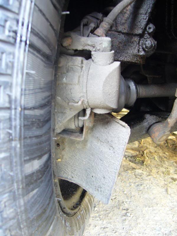

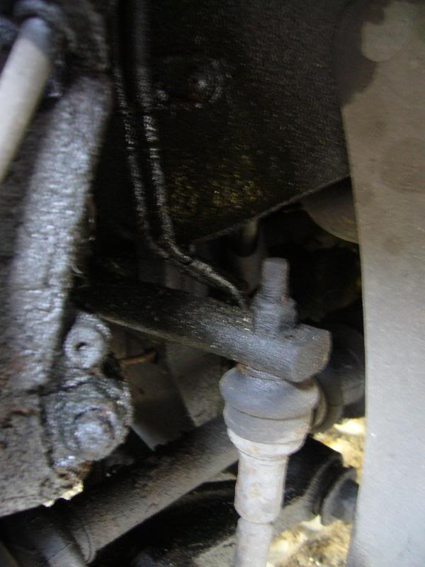

...and dampness in the the nsf hub area show a leak there too.

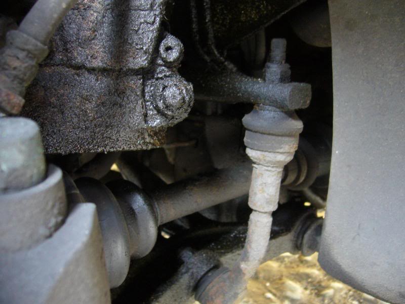

Viewed from the front:

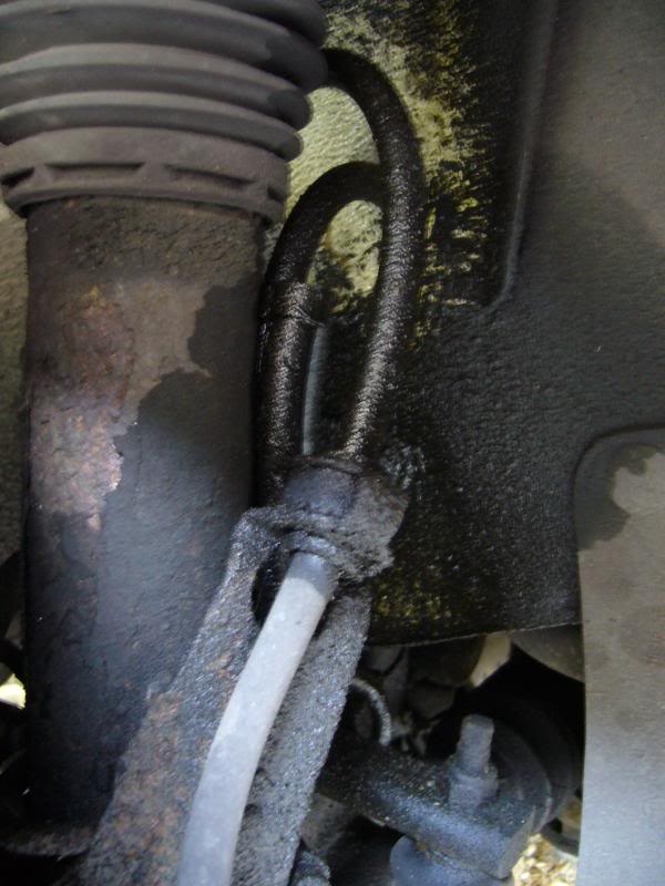

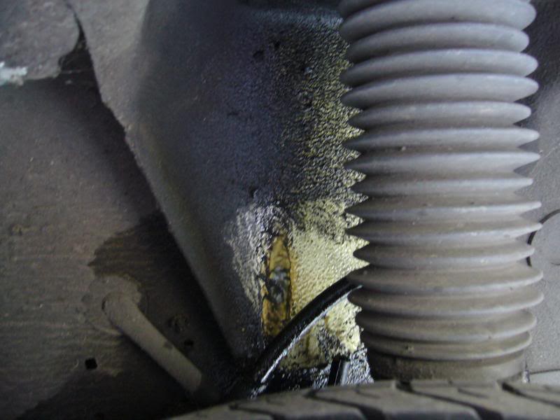

Now there's fluid on the tyre so it must be more than a slight 'weep'.
From the splatter pattern, it looks to be coming from the free end of this pipe.

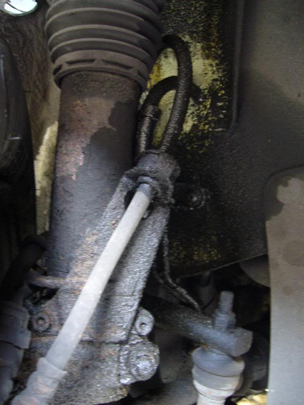

Viewed over the wheel:
The car goes up and down fine, and still drives lovely, but needs attention at both ends so I'm displeased to say the least :evil:

Does anyone have a diagnosis / treatment / prognosis on the front end LHM leak?

Typical BX issue. The rear arm bearings do need doing, and sadly it isn't cheap: I got a pair done last summer by my local specialist and it cost £320 all in.
But given the car was so cheap in the first place it wasn't too painful.
The front issue could be leaking strut return pipe. A common failure and not pricey to remedy.However I'm not sure as the leak is usually evident in a slightly different area. Someone'll be along with a better idea I'm sure.

£30 for a bearing kit sounds about right, and yes yours do need doing. The strut return pipe should be around £7-10.
Yes your front leak is just the strutt return pipe, that 'free end' you refare to actually looks like a split pipe, very common and easy to fix.
Defender110 wrote:Yes your front leak is just the strutt return pipe, that 'free end' you refare to actually looks like a split pipe, very common and easy to fix.
I knew it really... I should have courage in my convictions. !!! :roll:

Looking at my pictures again, could the pipe have broken and separated completely? Is that what I'm looking at? I'm in my PJs now, so I'm not going out with a torch to whip off the wheel and poke my freshly shampoo'd head in the wheel-arch!
If that's the case, this 'return pipe' must only carry a bit of fluid at low pressure, is that right?
If so, could I just slip in a bit of steel/copper pipe, or sleeve it with rubber pipe? (Secured with little jubilee clips.)
Would I encounter issues of pressure? What about the material... does LHM dissolve anything?
I'm a fan of a semi-permanent bodge, if it does the job and saves a bob. Can you tell?

KruJoe wrote: I'm in my PJs now, so I'm not going out with a torch to whip off the wheel and poke my freshly shampoo'd head in the wheel-arch!
Stick with BX ownership and you won't need shampoo much longer! :lol:
Yes thats how they go, it is just a clean break almost looks cut, i'm of similar ilk and have repaired one of mine using small bore nylon tube and very small fuel pipe clips but I have now done it 3 times as it just splits further along the pipe so I have now ordered a new genuine return to do the job properly. GSF copies are poor quality and several members on here have had less than 12 moths sevice out of them.
