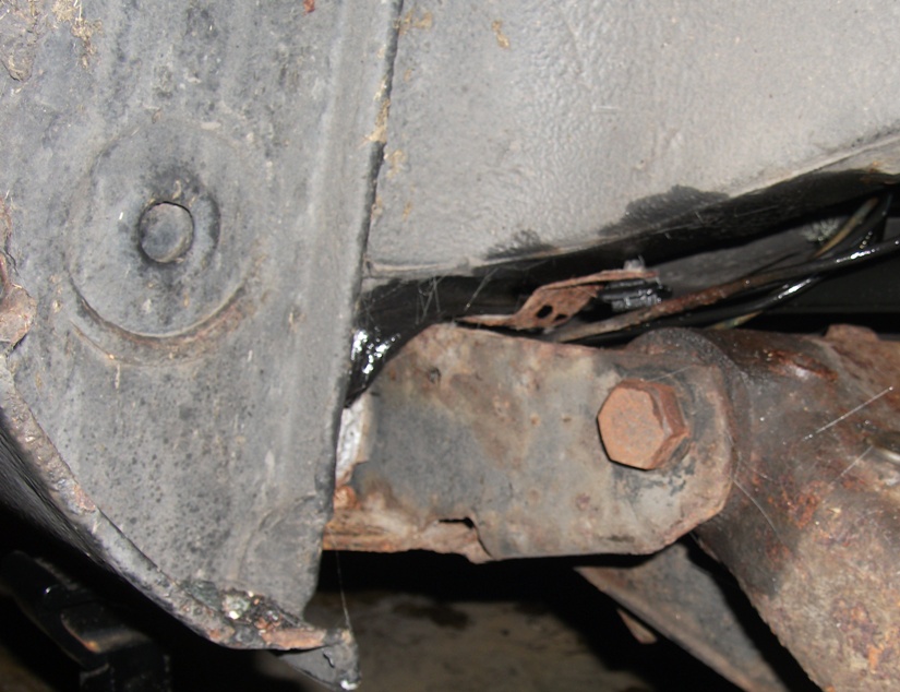

I've taken a couple more pics, below.
Thanks for the good wishes
cheers, Brian
I've put an arrow in this one showing where the hole is (it's at the back of the pipe where the arrow tip is, a small pin-prick sized hole)
This pic shows where the pipes come round the rear subframe, the flash makes them look worse than they are. The LHM is from the spray from the hole near the HC (it gets everywhere at 2000 psi). I had already replaced one of the pipes (right at the back), that was the pipe from brake master cylinder to T-piece at the rear. It went round the subframe etc quite easily. I might replace the others as well as the one that's got the hole in it.

Yeah that's been done by several people on the forum before.
It needs a flare tool to do the job in situ, and I'm not sure that there is enough space, nor enough pipe left as the hole is very close to the Height Corrector (see arrow 2 pics previously)
Here is a pic of the pipe I replaced on the rear brake T-piece over 3 years ago. The main arrow shows where the hole was (that is now the new pipe). The smaller arrows show where I undid the unions that go to each rear caliper so that I could remove the T-piece to get the old union out of the T-piece in a vice.. You can see the new union on the T-piece, the new pipe runs all the way to the front connectors on the chassis. The point is that the long pipes can be replaced without dropping the subframe, providing you take your time and use an assistant to help (see also previous pic).

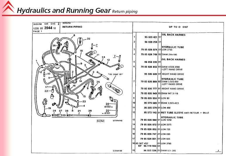

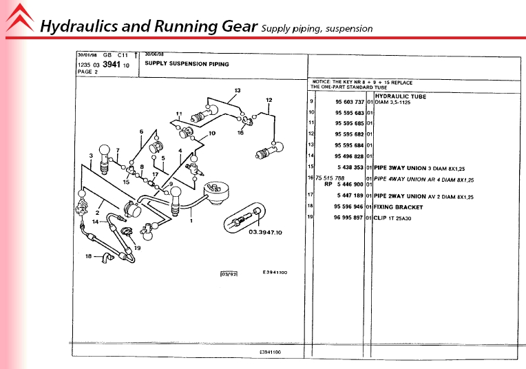

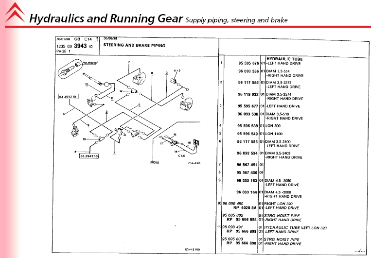

I've found the following for the part numbers I will need
10, & maybe 11,12,13 here
2, & while I'm at it 6,7,8 here
18 here
