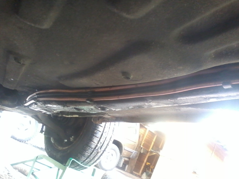

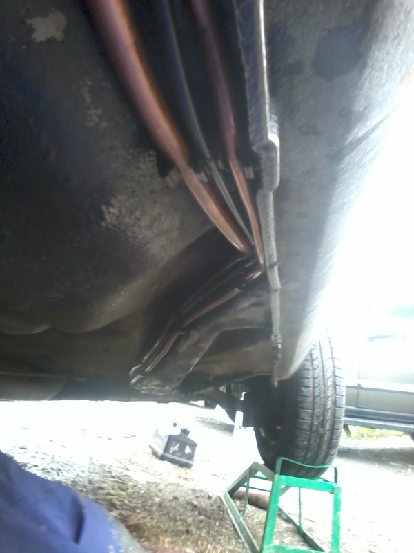

- Posts: 7330
Re: Uneven revs
I'd be more likely to suspect the steel fuel pipes themselves, as in my experience they fail before the rubber ones (who do extend all the way into the engine bay BTW). These photos show the pipe run (the join to rubber at the front can just be seen on the first picture):
Re: Uneven revs
Thanks. It is indeed the metal ones, rotting where clipped to the body. Replacement pipework has been ordered.
