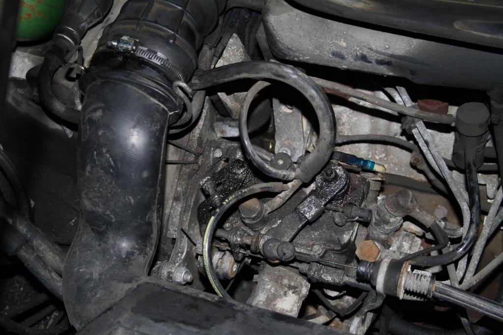

Here it is.
Can't find anything that says one way or the other. Certainly not that much like the Bosch one on the Green Tiger, but then this is a turbo with a very different fuel supply system (filter in the 'stat housing).

thats a Lucas pump Ian,

There's no throttle in a diesel, so it must be extra fuel getting in somehow. But how I don't know! Not very familiar with the Lucas pump, but is there a cable leading to the thermostat housing?. I can't remember if there is a cold start enrichment (waxstat) or not. Even if there is I can't see this being solely responsible for raising the revs that much.

There is, but there's plenty of slack in it when it's doing this. Not sure the waxstat is working. I'll have to check the cable tension when cold. Could be that someone has just upped the tickover to compensate for cold starts hence why it seems a bit high all of the time. Doesn't explain teh high revving though. I really don't like that!

Not sure this will be the problem but your throttle cable looks very tight, there is usually a little free tension and I can't quite make out from the picture if the throttle arm is actually hitting the throttle stop screw or relying on cable tension?
Re: Uneven revs
It is hitting the stop. No time now as it's packing-for-the-show time, but I shall explore further next week.
